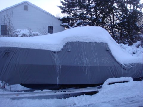

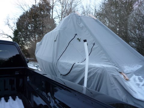

We purchased a heavy duty winter canvas that was done by Fisher Canvas in Burlington New Jersey. It is supported by one long wooden 2 x4 in the front and two 2 x 4 's in the rear. It has a zippered access door. We leave a small electric heater on all winter. The shrink wrap thing seemed to be money out the window over time. I know it can be used over but a decent winter cover cost around 1250 dollars and we have had it for 5 winters, you can do the math. We like being able to go aboard for winter projects and just to insure everything stays peachy in the cabin area. We run RV anti freeze thru any of our water systems which include raw water wash down and the fresh water system. I would remove any canvas or cushions and store them in a dry place. Because we sometimes have mice, I bought a Rubbermaid dock box at Home Depot for a little over $100 dollars. I roll my camper top sides up after making sure they are completely dry using big towels and those swim noodles. Then I put them in individual canvas bags that have sewn on canvas handles. We do this because we trailer our boat a lot and it makes them easy to handle plus it protects them while in transit. Then we put them in the dock box located in our garage along with herbal mouse repellant that contains spearmint leaves called Fresh Cab. www.earth-kind.com I also duct tape a heavy duty trash bag around the trailers winch and tuck the electrical connect for the trailer inside the bag before duct tapping. I would use some anti mildew stuff in your rear lazarettes compartments along with your anchor rode area. Some folks spray their electrical terminals and the power head of your outboard with a anti corrosion blocker. We use WD 40 although some might find fault with that and would recommend Boeshield T 9. I would make sure your fuel gets treated with Blue Stabil or the marine ethanol additive to prevent phase separation or the other after effects of ethanol laced gas in stored gasoline engines. The dealer might have already seen to that. I lube our sliding window channels with Mary Kate liquid Rollers so they slide open easy in the spring. I shoot a little Febreeze in the cabin for good measure.
