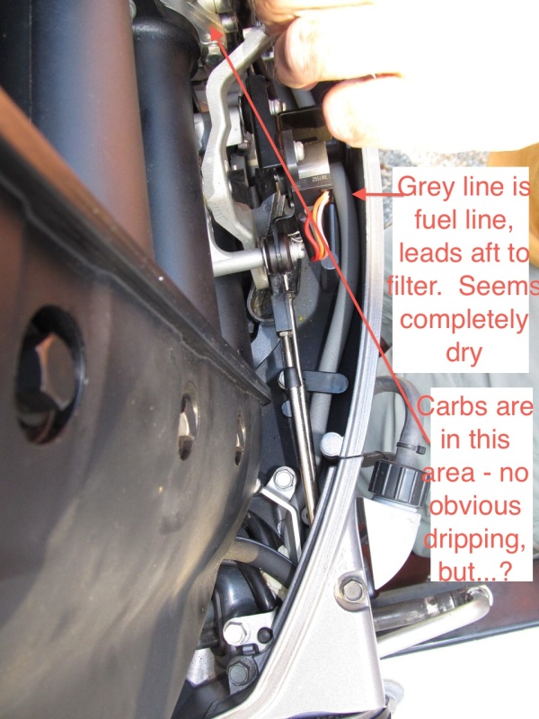

There is clearly no gas dripping out of any of the hoses, the filter, or anyplace else. I found two brown lines coming down the motor cowling handle (just below the bottom of the cowling), but nothing sprayed around on the inside of the cowling. Hmmm. Then I found that there is a small hole in the bottom of the engine skirt (the part that is the bottom of the cowling that doesn't come off, if that makes sense). That hole has a little rubber stopper type thing in it (factory), and the gas had leaked out of there, and (now I could tell) through the gap where the handle/arms of the latch go in. So in other words gas had somehow pooled in the bottom "skirt" part of the engine below the cowling, and then dripped out when the engine was tilted up today. Not sure why it is a little bit thicker and "syrupier" than pure gas, but maybe that is a clue?
I looked all around inside the engine but can find nothing leaking. The built in fuel filter and hoses and joints are all dry, there is nothing obviously sprayed around inside anywhere. The carbs smell like gas if I put my nose up to them - I would presume that might be normal but.... is it?

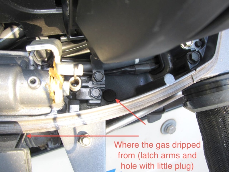

Here I've pointed out where the gas left the engine and dripped out. Not really a mystery as there are "gaps" in the skirt at those points. So that's just where the gas got to when the engine was tilted, I believe.

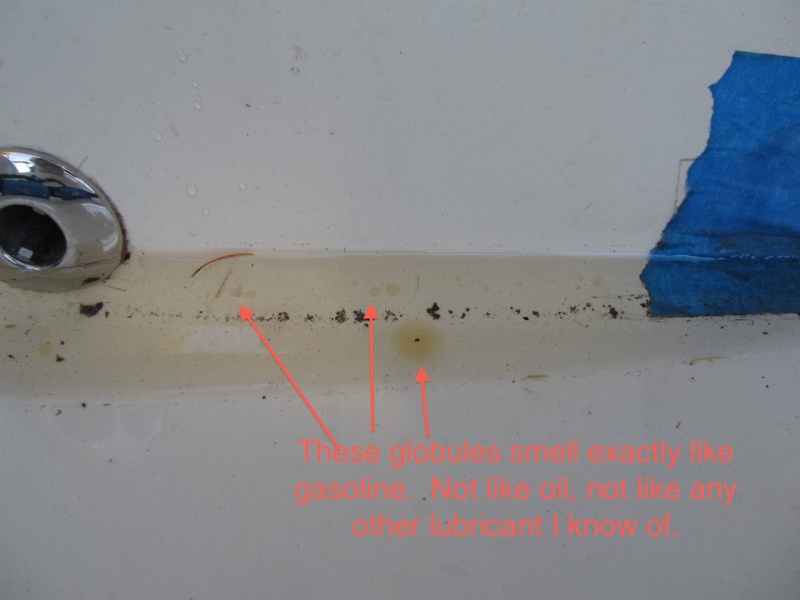

If you can look past the dirt (why does it always look so much worse in a photo?), you can see the brown globules. I thought it was interesting (maybe a clue?) how it stayed in globules vs. spreading out more. It smells like pure gas though, not like anything else in the way of oil or lube.

Sounds like you had a float that did not shut properly, for reasons that we can only speculate ...
I wouldn't worry about it.
A lot mechanics recommend running the carbs dry before storing or transporting the boat.

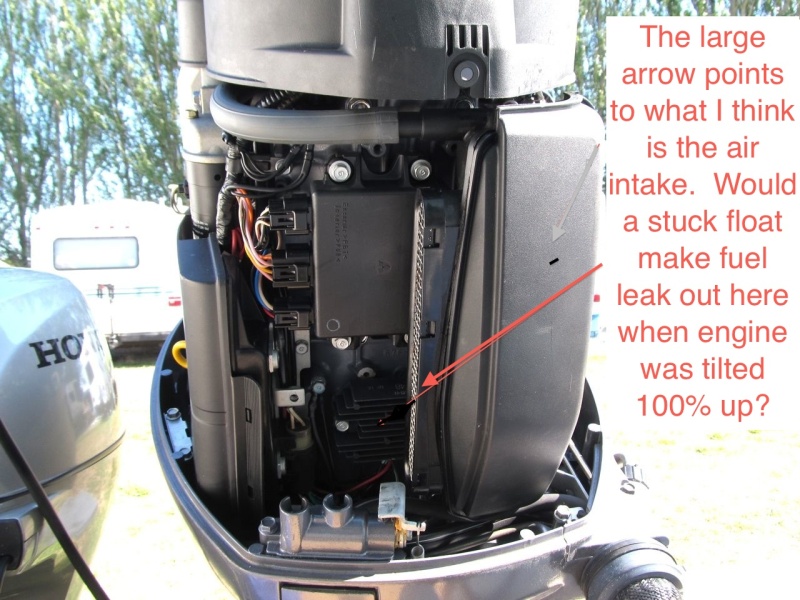

PS: Here is a photo that shows what I think is the air intake (vertical silver woven grille)

Put the 'muff on the Yamaha, pressurize the fuel line and run the engine. While the motor is running carefully inspect the areas where fuel seemed to have dripped-out. If you see anything leaking it may give you a clue as to the problem (IF there is a problem). Naturally you'll want to be VERY careful when being that close to a running, unshrouded motor.
Have a good flashlight and a small mirror handy and give it all a close inspection. A little toilet paper tucked into suspected areas will help reveal any new leaks or drips.

It could just be the vent lines on the carbs. When tilted all the way up gas ran out the vents. Run the engine like Casey said and see if anything is leaking. Then drain the carbs and tilt the engine all the way and see if you still get gas leaking. There should be a vent line from the carbs that just terminates somewhere. That's probably what I would look at first. If it isn't leaking in the running position I would just drain the carbs and goto Lake Powell.

The pic doesn't look like gas to me...if it was gas you wouldn't see it. Must be oil and grease and maybe a little gas...I bet it is residue from the cowling that has been there a while and worked it's way out with the up and down on the motor. Whenever you work on the motor...whether changing the oil or servicing the carbs...you always drip something into the cowling...and it is impossible to clean it all up unless you completely tear it down.
The carbs each have a vent port that will pour fuel into the cowling if a float sticks. It will be anything from a little drip to just pouring out the side of the carb.

Not gas. Gas doesn't glob up.

I do think it was at least mostly gas because.... well, just because I have a good nose, and to me gas doesn't smell like oil or lower unit grease or any of the other lubes I know of that would be in the vicinity. But I do agree with you and Chris that it must not have been pure gas, because it pooled "oddly," as you could see, and with pure gas I would expect a thin surface film and rainbow, not an undissolved circle.
What I think now is that it probably was gas that traveled over some grease on the way out (such as, there is a large glob of grease on the inside of the latch mechanism, and there were two "trails" coming down the latch face from where it came out through that gap in the skirt) and maybe they blended slightly in the process.

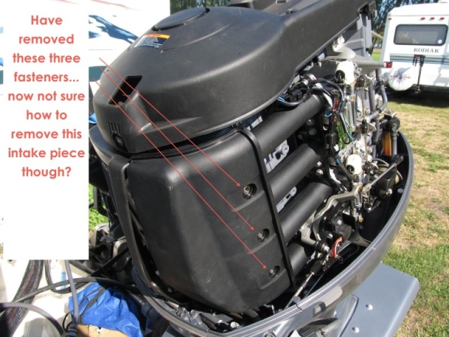

Carb draining question:
One question that I don't think shows in my manual: Specifically how do I drain the carbs? This is something I need to know anyway. I had them drained by the mechanics who went over my engine when I first bought it, so have never done it (and now there was only going to be gas in them for a week or so on the way to Powell, so I was potentially just going to leave it...)
I do remember the mechanic telling me that the fourth (bottom) carb was a bit of a bear to get to. I have read that there might be clear tubing that I put over something on each carb while it drains? (Maybe that was Honda specific.)
I will go take a side-on photo of the carbs and then post it. Maybe someone can then draw a "circle and arrow on the backside" or otherwise describe how to drain them?
