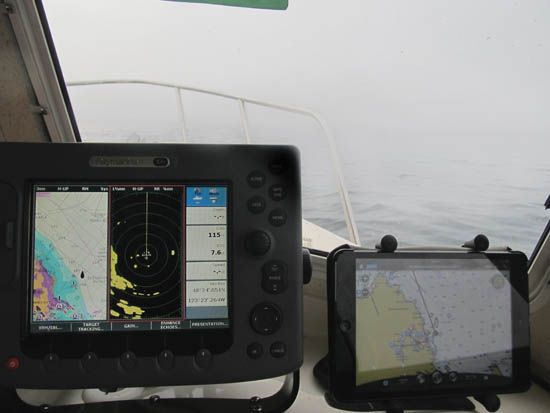

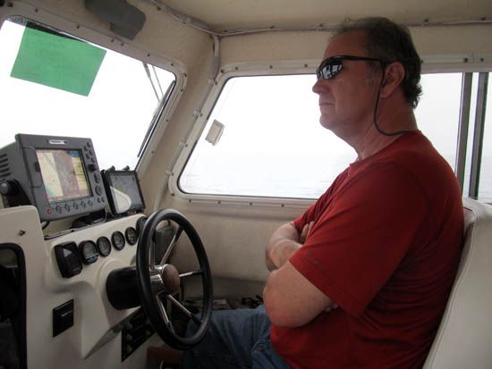

Hi Mitch and Martha,
We have an original iPad and an iPad Mini. I use the Mini at the helm, alongside our Raymarine E-Series chartplotter, Joan uses the original iPad. We came across from Victoria today in fog...
http://captnjim.blogspot.com/2013/09/back-to-usa.html
Here's a look (watching for traffic, monitoring the chartplotter, iPad, and radar)...
The Mini actually fits better alongside the Raymarine Chartplotter on our helm. I used to use the bigger iPad, but had to use it on the other side. No issue with the function and read-ability (if that's a word) with the Mini.
If I were only going to have one iPad between us, I'd go with the full size. Our original iPad is getting a bit long in the tooth, and I think Joan is ready for an update... it will run Navionics, but not the Garmin BlueChart app (due to memory). I use both (well, either) on the Mini.
Hope that helps.
(No doubt you have been following the various iPad discussions, but I really suggest a 3G/4G model for navigation use, even if you never connect directly. The wifi only models DO NOT have a built-in GPS chip.)
