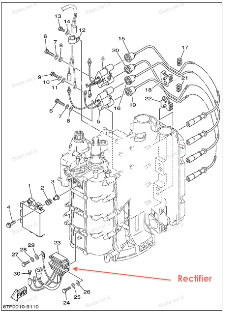

1) This is an electrical diagram - the rectifier is part #23, at the bottom/forward of the engine. I can see how this removes/replaces, but there are other parts in front of it which I'm not sure how to remove.

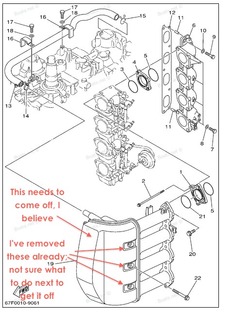

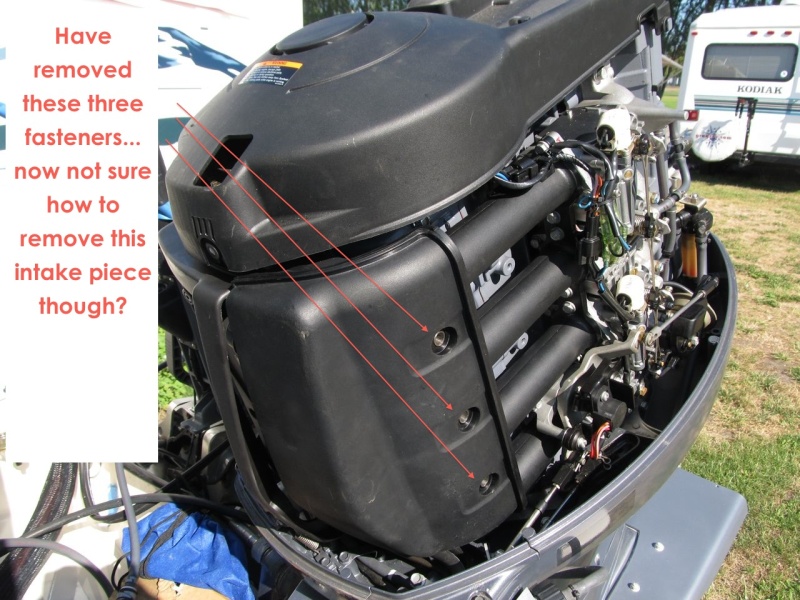

2) Here is the intake diagram. Part #19 needs to come off to access the rectifier, from what I can tell. I have removed the three bolts on the right (port) side, but... there seems to be more holding it on. Looking at the parts diagram, "more" seems like it might get into the intake manifold/gaskets.... and that just doesn't seem right. I'm hoping one of the folks who has done this before might have a memory jog looking at this diagram. You know how it's scary to "force" something (plastic) when you aren't sure if you are doing it right...

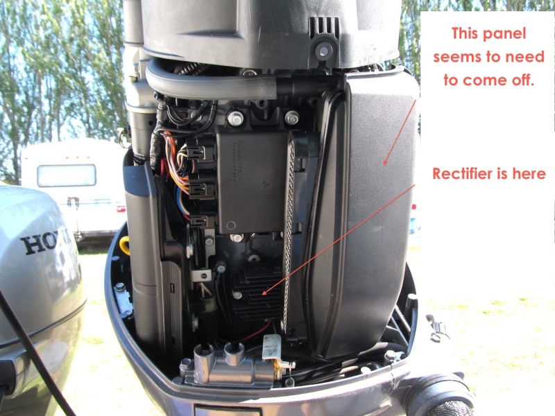

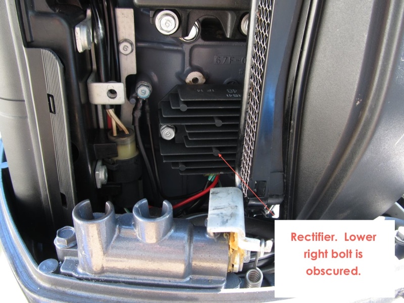

Here are photos of my engine. This is probably something super-obvious, but I'm not outboard-mechanics savvy (probably obvious by now) Embarrased

Well...it's been a while...replaced mine on the water in Craig, Alaska...so not a huge job...but that air cowling needs to come off. There are about 8 bolts holding the black plastic cowling to the cast aluminum intakes. Not a big deal...you are not getting into anything complicated. As I remember it didn't need to come all the way off...just enough to gain clearance for that mount bolt on the rectifier. Also...I remember a bolt low on that air cowling on the front of the motor that was a challenge...needed a u joint for my socket drive...didn't have one aboard...had to walk up to the Napa in town to get one.
Biggest danger on this job is over torqueing the bolts and breaking those plastic pieces...go easy on those when you go back together.

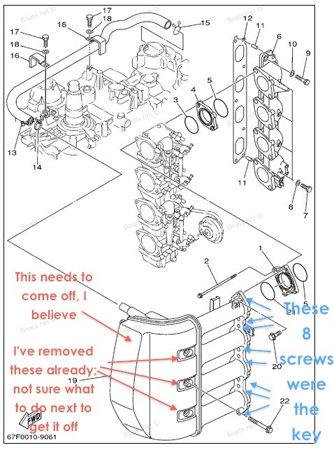

Just thought I would follow up and say that the new regulator/rectifier is on, and the original is a labeled spare Very Happy Chris, thanks for the tips and encouragement. I'm impressed you got it done on the dock - some of those fasteners (on the intake) were a bear to get to and I had to come up with some creative tool combos.
Here is the intake diagram with some added notes, in case anyone else can use the info.
