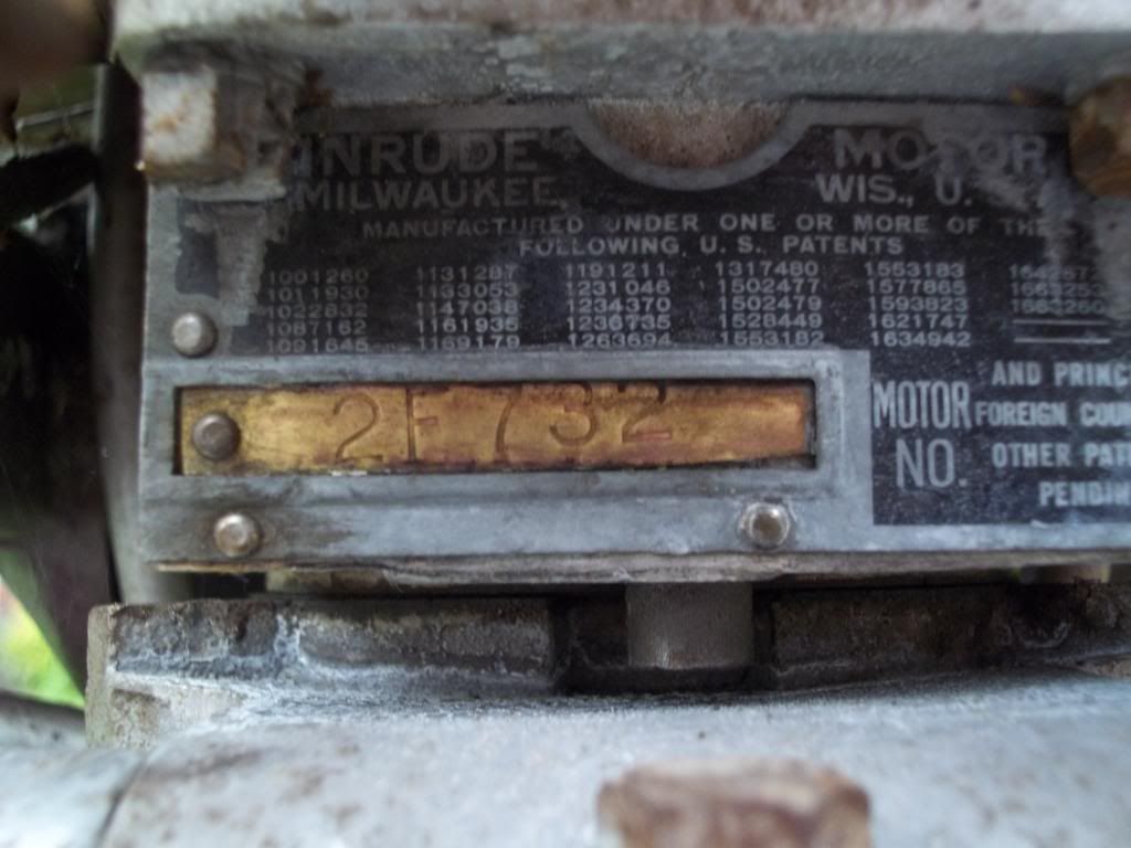

My friend has an old Evinrude motor he is trying to determine its age and value. Here's what is on the motor:
Evinrude Motor Company
Made in Milwaukie, Wisconsin.
The Original Evinrude Fleetnoon ..< ( not sure if this is spelled correctly )
Motor number 2F732
and there is another number on the plate as well..B100J
any ideas : thanks

Evinrude built a model 732 engine in 1933 that was 31.2 hp. If 732 is your model number, that may be the engine.

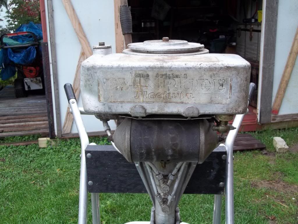

Oh, and I think it may be Fleetwood. That may have been an Evenrude tag.

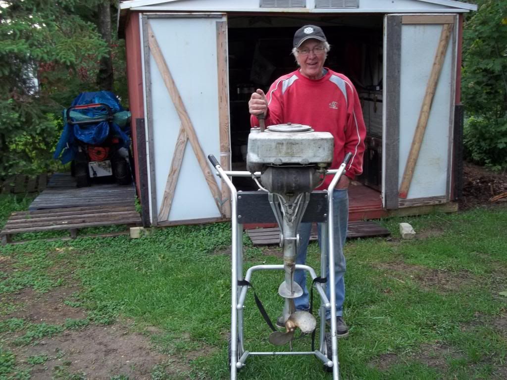

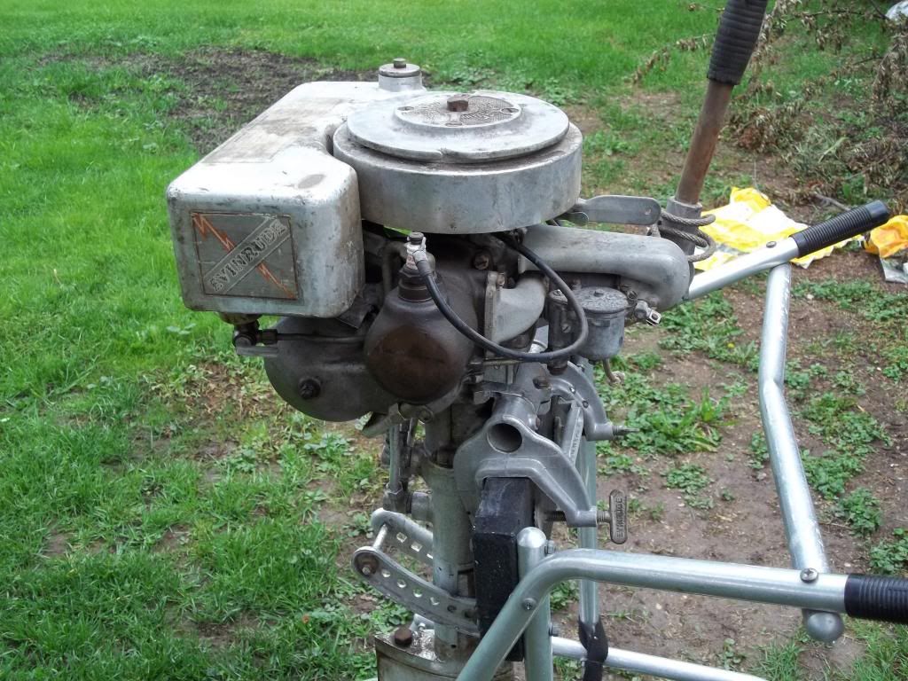

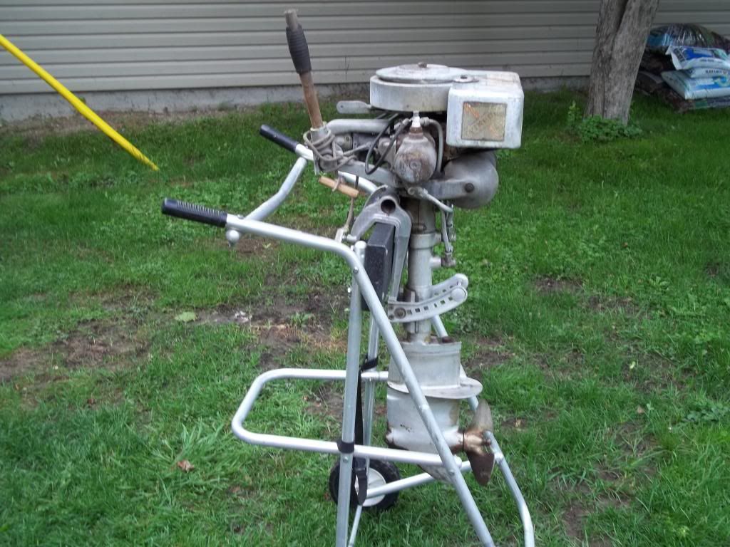

Yes it is a Fleetwin and he thinks it's a 7HP or a 7.5 HP

Now that's a true oldie! Sweet.

We had a 1935 Johnson which was similar, but a bit smaller than this motor. I would bet on the 7.5 hp and 32 or 33 as being correct. I also rebuilt another of the 5 hp which was at a summer camp I worked at--and both of those motors started right up--but you did have to keep the plugs and carbs clean.

I emailed the pictures to an Antique Outboard ( Evinrude ). dealer and this is the reply he sent me:
Your engine appears to be an Evinrude model " F " Fleetwin 1929.
The actual model number is 2F . It is serial number # 732.
The 2F was 7 hp.
The just pain " F " was 1928 and only 6 hp.
They were very good motors and quite popular in their day.
Your looks complete . The carburetors were very fragile and are often broken or missing on those motors.
Mystery solved ..thanks for all your help, it directed me to look in the right direction.
