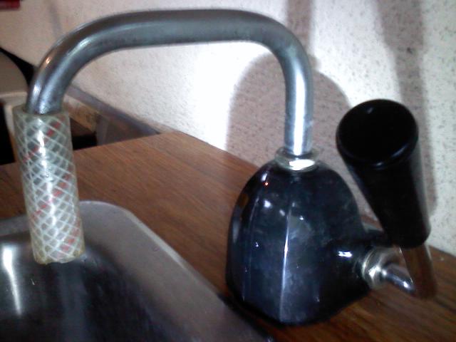

Can anybody tell me the make of this faucet ?
It will not hold a prime but I see no name to be able to buy a repair kit.
Thanks for any help. Smile

That looks like a Whale Flipper Faucet, but no guarantee. A lot of things have changed in 30 years. Here's a web site with an exploded view: Flipper pump

Thank you Boris, I just wish I could find a name on it to be sure but it sure looks like a Whale Flipper.

I found the name of the faucet on the big plastic nut under the sink.
Fynspray
I think I have the correct service kit coming. Smile
