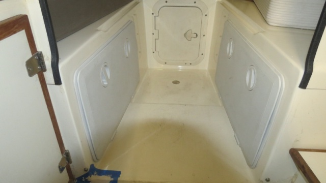

PostPosted: Wed Mar 13, 2013 9:24 am    Post subject: Reply with quote
See the area where the blue tape is. Not the subject of the pic, which was the tackle hatches.
The 22 Angler 2006 that I bought last summer had cracks in this same area. I just fixed them and will not worry about it. They appeared to me to be gelcoat cracking, not structural.
