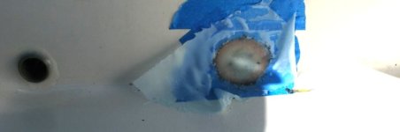

Moving around to the transom now.
If I'm worried about water getting into the core of a boat, I can't relax and enjoy it, so I'm taking care of some of the vulnerable areas. My boat lived on a rack inside a building before I got it (although I still looked it over carefully with moisture in mind), so I figure now is the time. I want it to feel water-resistant Smile Two things that bugged me were the pair of brass drain tubes - one for the splashwell and one for the transom drain. The transom drain worried me more, since it's below the waterline, but I still wanted to improve the splashwell drain as well.
I debated various schemes. Underlying all of them was that I would remove the brass drain tube, ream out a good bit of core, fill with thickened epoxy, and then put *something* back in. It was the something that I was debating. My thoughts were as follows:
1) Another brass tube. I'm just not a fan of brass in a marine (potentially saltwater) environment.
2) A plastic tube, preferably Marelon. This was a contender, but then plastic doesn't really bond well to epoxy. Granted, the hole would be filled with thickened epoxy, but how much nicer if the tube could also be bonded.
3) A stainless through hull, with the mushroom side in the splashwell and the "nut" on the transom. This ended up being "Plan B."
4) A pre-formed fiberglass tube, bonded in place and bullnosed on the ends, then filleted, and ultimately gelcoated.
I decided to go with #4, even though I wasn't sure I could pull it off nicely. As a fallback, I found that a 3/4" through hull would fit inside the tube, so I decided to go ahead, and then if I didn't like the way the tube came out, I could always cut the ends off off flush and simply insert the through hull - still with the advantage of a bonded fiberglass tube doing the "real" work, plus with sealant (caulking) on the through hull.
First step was to tape and protect the working area, after which I removed the brass drain tube. What I did was make three lengthwise cuts with a hacksaw blade, then use a cold chisel to "dent" one of the sections in, after which I could grab it with vise grips and pull it out. It actually came out ridiculously easily, probably because it had a mere whisper of sealant on it.
Thankfully the core was completely dry, although I have no confidence it would have remained that way if the boat was an "outdoor" adventuring boat.
Next (and at this point I was still mulling over my options, so I did not enlarge the hole yet) I used a combination of dental pick, screwdriver, and Dremel tool to remove the core (transom) and filler (splashwell molding) for 1/2"+ all the way around the hole.
Looking forward through the transom. The first layer is the balsa transom core, then the fiberglass of the forward side of the transom, then the (white) filler that runs between that and the splashwell molding, and finally the fiberglass skin of the splashwell.
At this point I decided to go with option #4, the fiberglass tube. I had previously ordered a section of 1" ID tubing from Mcmaster-Carr. This tubing is 1-1/8" OD, so I had to enlarge the hole. I didn't have the exact right hole saw, and also I decided that I wanted to do it a bit more "gently" (vs. reaming through with a hole saw all at once). What I did was cut a 1" slice of the tube to use as a marker, and place it on the transom and draw a line around it. I then used a Dremel with a sanding drum to carefully sand to the line all the way around. I did this on the transom side first, because in case it didn't come out perfectly it was on the less-viewed side. But it worked really well and came out nicely. I then inserted a ~2' long section of the tubing just to check that it would hit the splashwell the way it "should." It did so I then did the same enlarging there, checking things as I went along because I wanted the hole juuuust large enough but no larger.
Next I sat back and thought about the steps in epoxying, trying to figure out everything I needed to do in advance. I double checked the core and took out a bit more - it was easier to see/reach with the holes enlarged. Then cleaned and prepped for epoxying. I taped the "good" edge of the tube, which was the splashwell side (the transom side was going to run long until later). I made a little nose cone out of a popsicle stick and taped that on to help the tubing find the second hole. Then I mixed up a batch of neat epoxy and coated the tube and then all around the inside of the hole, letting the bottom of the hole "soak" with some excess before removing it back to just a coating layer.
Then I started filling the hole with epoxy thickened with colloidial silica. I did this in stages so as to avoid it getting too hot and/or foaming as it cured, monitoring the temps with an IR thermometer (not necessary, but fun nonetheless).
After an hour or two I was able to fill with a second (and final) batch. Looking aft from the splashwell after the second fill:
At this point I called for a friend and then put a bit more epoxy in the hole and "buttered" the tube. Then he installed the tube from astern while I monitored the splashwell side. When it was in just the right spot I taped it in place (although it did not want to move at all anyway) and removed any excess epoxy. Then I left it to cure.
The white area that looks like spilled milk is just a section of a plastic water jug that I used as part of my protection scheme.
The transom side ended up looking a bit like an impalement victim:
I let things cure for a couple of days while I worked on other things, and then I trimmed the excess tubing from the transom side and rounded it over. Next I re-taped leaving a bit of a margin, then I solvent-washed, sanded a thin margin, re-washed and then ran a fillet of thickened epoxy around both ends of the tube.
Here is the splashwell side after filleting. I think I may trim back the tube a tiny bit more before I sand the fillet, but I figured easier to make it shorter than to lengthen it!
The transom side looks similar, although I see I forgot to photograph it. Next I'll sand the fillet slightly and then I'll let the epoxy cure for a longer time before gelcoating. At this point I don't think I'll need to go to option #3 (through hull), but if I wanted to, a 3/4" one would fit inside the tube (which I would trim flush). I'm not a gelcoat expert, so not sure if I will tackle that part or not. I'll probably try some areas that are simpler and more inconspicuous first!

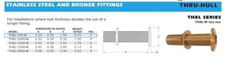

2. Could you post a picture, or link, or part# for the 3/4" through hull that was plan 3 and would fit inside the fiberglass tube you used?
There are probably any number of them that would work, but basically it would be a 3/4" through hull of the type that is threaded all the way through (i.e. not with hose barbs on the end). I would (have) put the finished (mushroom) side on the inside of the splashwell for a finished appearance, trimmed the spigot to just fill the nut and then put the nut on the outside (since there are already a lot of nuts, etc. there, what with the engines and all, and you really have to look to see that area anyway). Here is one example from Groco, although it happens to be bronze and not chromed or stainless. It is, however, long enough, which some are not.
Although they say this size takes a 1" hole (and it does), I still took a new 3/4" Groco through hull I had on hand just to make sure it fit inside the actual fiberglass tubeI had. It did, snugly.

Sunbeam,
A follow up question. It sounds like you are saying that a 3/4" Groco bronze thru hull fitting is snug in your 1" ID, 1 1/8" OD fiberglass tube. Is something off by 1/4" or am I missing something again. If you used one of these for the lower drain plug (not the splash well), do they make make expandable rubber plugs that would fit inside the 3/4" Groco thru hull? Or would you use some other means of plugging it?
Thanks again.
Rob
PostPosted: Mon Jan 14, 2013 9:28 pm    Post subject: Reply with quote
Rob & Karen wrote:
Sunbeam,
Hi Rob,
A 3/4" through hull is actually 1" OD, so that's where the "extra" 1/4" comes in.

Funny you should ask, as I'm much of the way through the lower drain project too Laughing (I'll add it to this thread later). Again, I considered a number of options. Ultimately I decided to completely close out the core, so I'm not going back in with any sort of tube, but rather just a regular drain plug ("garboard drain") type fitting. However, if I had not done that, and had gone back in with some sort of tube, then bonding in another section of the same fiberglass tube, and using a common 1" plug of the expanding type - just like is in the current brass tubes - was a prime option. But I suppose one could possibly also put a drain plug fitting inside the tube and then the threaded plug that comes with that style. You'd probably want to see how the OD of the tube cleared the drain fasteners. Probably the "Thermos" plug would work out more easily.
Buck Algonquin do actually make a "through-hull" style drain plug, but it's not long enough to go in with the tube style drain. I have ordered one of these to check it out for my "revised" lower drain (I'll likely either use that or a regular garboard drain type fitting).
Sunbeam Hot
PS: The fiberglass tube stock also comes in larger sizes, so one needn't necessarily be limited to the 1" ID. I originally ordered that size because I was thinking I might use it for the lower drain, and wanted an existing rubber drain plug ("Thermos style") to be able to fit it. I knew I could get 1" plugs (although my original brass "Thermos" plug was more like 3/4"-7/8").
