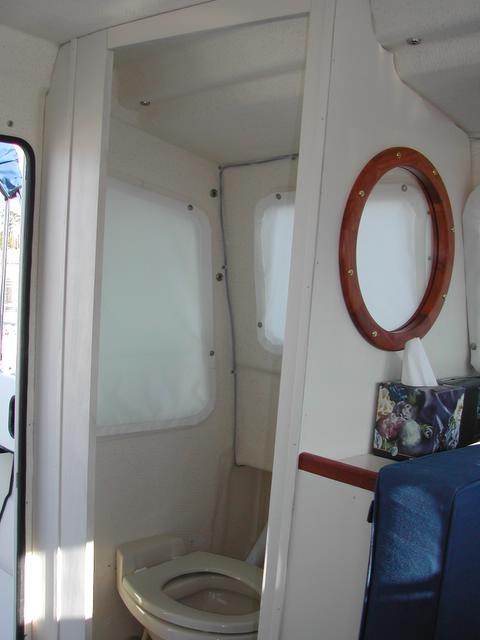

The owner of DORYME, a 22 Cruiser, constructed a head (room) in the port after corner of the cabin. It looks like the forward co-pilot seat was retained, and the dinette table and after seat removed. If I remember correctly the owner of DORYME said that they ate in the cockpit with a table and chairs there (even before the conversion). There are photos in DORYME's album here:
http://www.c-brats.com/modules.php?set_albumName=DORYME&op=modload&name=gallery&file=index&include=view_album.php
Here is one image from the linked album:
Posts: 7932
PostPosted: Tue Dec 11, 2012 6:00 pm    Post subject: Reply with quote
Note that his hot water heater is electric only. There was a post this summer about other gas fired instant hot water heaters.

When the factory was in Auburn, I remember seeing a new 22' that the factory was custom installing the head on the starboard rear corner of the cabin. Personally, I wouldn't choose to have a designated head in lieu of the standard features of a 22' (ie: galley, dinette, etc.) and am satisfied with a porta potty.
I have to admit that the install shown in the picture of the head installed in the previous post looks good.
