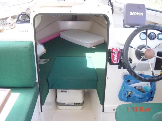

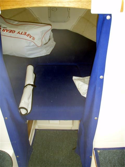

PostPosted: Thu Jul 12, 2012 10:02 am    Post subject: cd v berths Reply with quote
I think this is what he is refurring to on the cc-23 there is a2-3 in gap a lot of c-brats have remade another cushion
there is a larger gap on the cd-22[img]

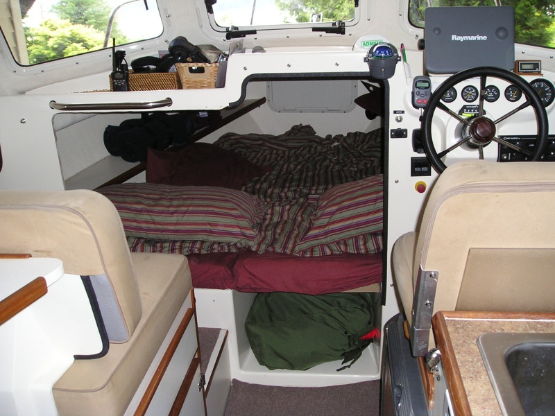

This is a pretty simple fix. I just did it yesterday. First I put vinyl siding soffit material cut to shape to give a 3/8 inch airflow space under the bunk cushion. Then cut 2 round 3 inch holes in vee berth bulkhead fronts with grills to add ventilation to lockers and up thru bunk bottom. The porta potty lives in the front section where the cutout is and my partner also wanted that area filled for cuddle time. Easy. I got a piece of 1x10 pine 22 inches long. Covered with 2 layers of memory foam and linen cover. This sits on the bunk edges and up against the bunk entry to come up to the cushion height for level. I then got the best recommended mattress foam cut full size for the berth area 3 inch thick. ( not memory foam) was not recommended for heat retaining issues. The vee berth is now filled strait across the back. Plenty room to cuddle. We kept the original cushions and put the new matress on top So have about 6 1/2 inches foam up there Comfy!!! Also the potty comes strait out to the floor then goes back. The board over is just a wedge fit. Take it out if wanted. Total cost. Board to fill area $12. Had memory foam on the old topper to make a cover. $250 for new mattress. For weekending perhaps overkill you wouldn't need the new matress for full time liveaboards make first mate happy I will put pictures in album soon. George

got some quick photos in my album, an hours work nice mod for comfort and interpersonal relationships.

Made a filler to extend the gap. It is two pieces - plywood piece stained teak with velcro on bottom to rest on bunk floor edges, then cushion which snaps (bottom side) to the plywood. This accomplishes two things: extends the bunk into a super length and provides an additional seat when multiple people are aboard, even if seating is facing the cockpit. Also, a handy place to place the left leg for us long legged folks at the helm. Yellowstone John
