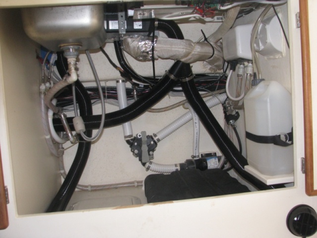

Rob, Here is a picture of the heater installation on Discovery. You can look at all the Espar heater pics in the heater install album, in the Discovery albums. The combustion air intake is the smaller black hose near the center of the pic. The intake runs for a few feet rearward with the wiring bundle, behind the head compartment. The fresh air comes in from the cockpit around the wires.
