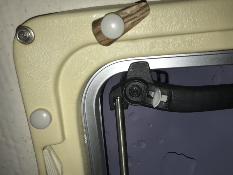

In another thread somewhere, I can't find it now, I mentioned that my hatch was leaking and I couldn't figure out how to tighten the latch mechanism. Well this evening I figured it out. Had to get a flashlight on the problem. Once I was able to actually see the thing, I found there is a small plastic cap on top of the screw that holds the latch together. This is on the inside of the boat. Once I found the screw, I was able to tighen it up. It was pretty loose, so I'm hoping that was the problem. Guess I'll find out with the next solid rain. Colby
Look closely, and you can see the screw that was hidden by a small plastic cap inside the latch.

Good job Colby,
We also had a very small leak from our forward berth hatch. Once I found that small black screw after removing the plastic cover hiding it and tightening the screw a bit, the leak stopped. Once the screw is tightened just a little bit, the handle feel is more firm and the securing of the hatch will have more resistance as it is locked. This adjustment will pull the hatch down more firmly on the gasket seal. Problem solved!
