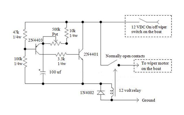

My next project is to build a true intermittant wiper control system. You would turn on the wipers with your rocker switch and then adjust the delay timing by a potentionometer. I am showing the circuit that I plan to use. The complete system will be posted in a few months with parts list and pictures to show the whole deal in detail.
Here is the schematic. It should be plug and play with two holes drilled in the fire wall for the potentionometer shafts to stick out below the switch panel.
