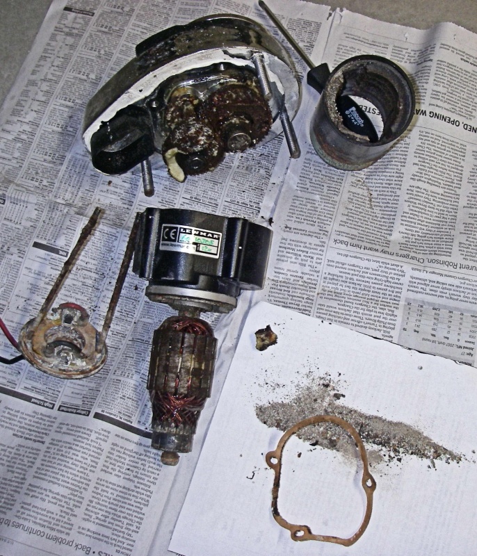

I disassembled the Lewmar 600 winch to see if I could rebuild it. Here's what I found. Grit/sand from the anchor rode had entered the gearbox, made a good grinding paste, and then migrated down to the motor. You can see the grit that came out of the motor on the lower right hand corner, a fist full. That's only the grit from the motor, there must be more than that mixed in with the grease. All the bearings are frozen and the motor doesn't turn. This winch is scrap.

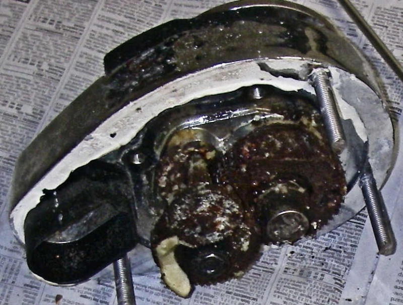

Here's a close up of the gearbox, showing (not too well,) the grit and water mixed in with the grease. That must be a cruddy seal they used. I can only pray that the V700 has a better seal, though it has the same motor. The V600 lasted for 5 seasons, that's all.

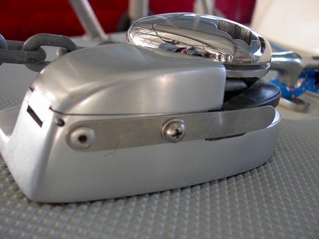

1. I added a booster spring externally to help push the Fleming (pressure finger) tighter against the rode and into the gypsy's teeth/chain pockets.

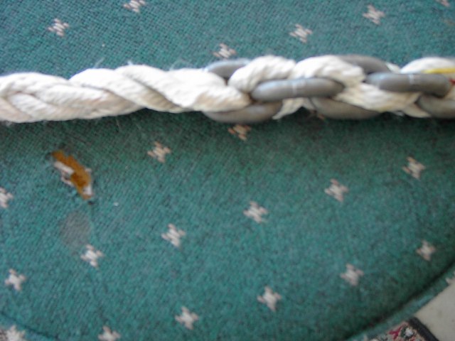

2. I developed a different splice, wherein, instead of weaving all three strands of the rope back down the chain, two of them are woven forward into the chain, being sewn at each crossing (link) together, and the third strand is woven backward into the rope similar to the traditional splice. This splice is considerably smaller in diameter through the joining area than the traditional one, and passes more easily.
