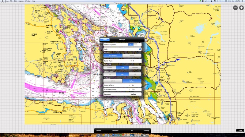

Bob, the Navionics PC app is indeed a different program than any of the ones you mentioned. It's appearance is very similar to the iPhone app (I assume the iPad app too, but I've never used it). Here's a screenshot:
As far as I can tell this is the cheapest way to get Canadian charts on a computer. If you buy the same charts through X-Traverse, they run $250, and the Canadian government charges around $600 for their official charts, I believe. Navionics sells the 2XG region (Great Lakes, SE Alaska, Washington State, all Canadian coastal waters) for $30 through their online web store. As far as I can tell, these charts can only be used in the Navionics app which is available for Windows and Mac and included with purchase of charts. The chart files themselves have a .nv2 extension rather than the more common formats that are readable by a number of programs.
