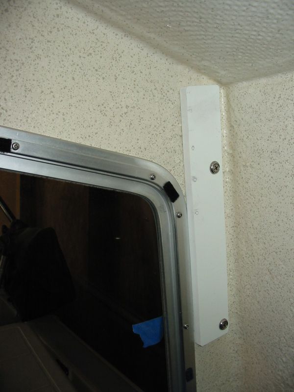

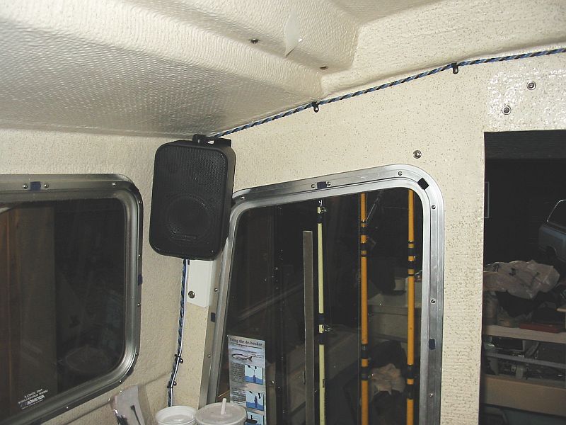

I installed box speakers that were recommended here. Audio Source speakers(LS 100). $40.00 delivered to my door. Sound great. Put them up in the corners.
No holes drilled.
1/2" Seaboard(Tap Plastics)abuts window frame and allows speaker bracket to be scooted over to clear wall. No holes and speakers rotate over 90 degrees.
Stereo install HERE
No holes for that either.

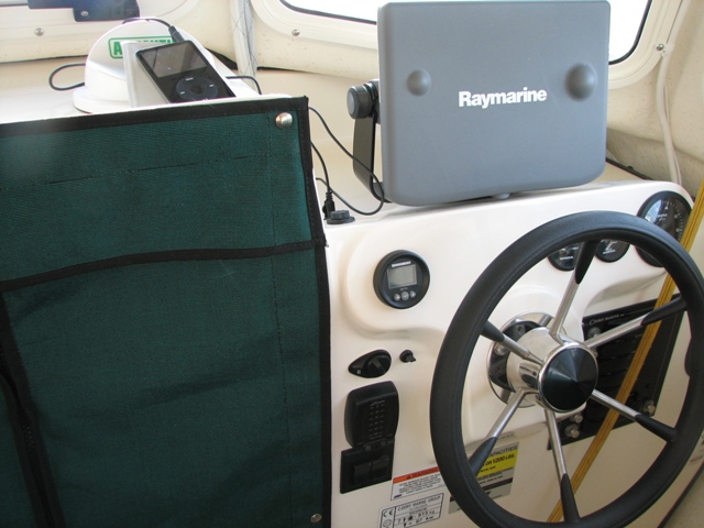

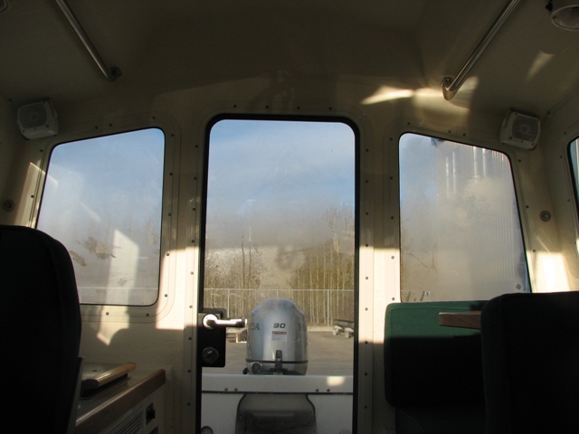

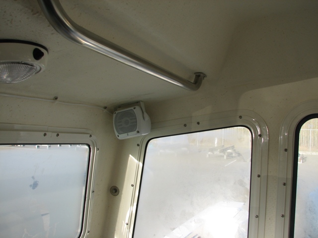

I used some small, inexpensive Poly Planar box speakers. I didn't use a head unit and went with a simple amp, aux input, and volume control. I just swap out which cable is plugged in when I want to play audio from an iPod/iPhone/iPad or satellite radio. The sound is fine for music, moves, and talk radio, but I'm not too picky.
Speakers out of the way in the cabin corners.
Closer up view of a speaker.
Toggle switch and volume control are just above trim tab indicator.
