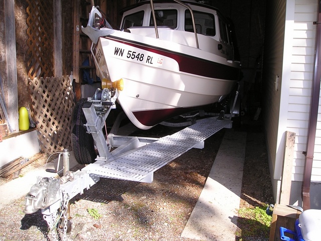

Pete, I also have a similar situation. Concrete ramp with no dock.
This catwalk I bought from a guy for $75 and my neighbor re worked it for my trailer. All hot dipped galvanized. Three 3" brackets drop down over the 3" frame to support the catwalk. This originally cost the guy about $1000 I think he said. A little pricey for him, not for me at 75 bucks. It is now laying on the garage floor awaiting the new 25 trailer. I am still working on having a ladder up to the bow from the winch area.
