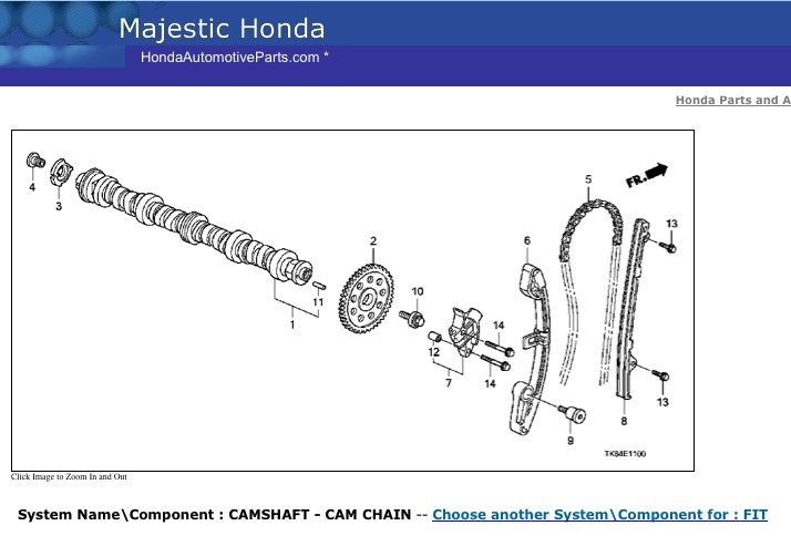

I got the same information about the Honda 90 FI motor as starcrafttom.
A water taxi operator in the Broughton Island area of BC reported that the motors are failing at about 750 hours.
The part that fails is the cam drive chain which then destroys the powerhead.
Reportedly, the commercial operators in that area are sticking with the carb Honda 90 or going to Yamaha.

Larry, had this water taxi operator personally experienced a failure or had he just heard of them?
Is the "cam drive chain" something that is supposed to be replaced or serviced periodically? I just looked in my owners manual, and found no mention of such a part.
Larry H
Posts: 2041
City/Region: Tulalip,
C-Dory Year: 1991
Photos: Nancy H
PostPosted: Tue Jan 03, 2012 10:46 pm    Post subject: Reply with quote
20Dauntless,
The person who spoke to me did not personally have a failure, but he reported that other commercial operators in his area, that he knows, have had failures. My source still runs the carbureted Honda 90's on his boats.
As I understand it, the new Honda 90FI is based on the Honda Fit engine, which has a chain driven cam. It is this cam drive that fails. My quess is that its because a horizontal engine was turned upright to create the outboard.
I am not a Honda expert, but I would like to hear more about exactly which parts are the problem.
