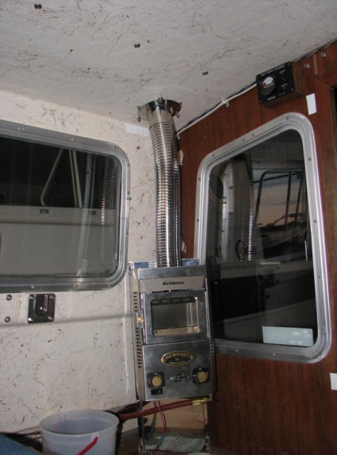

I too mounted a propane fireplace in the Sensei.I made some mounting brackets out of aluminum flat bar and bolted them to the wall. here is one pic and more in the Sensei photo album
