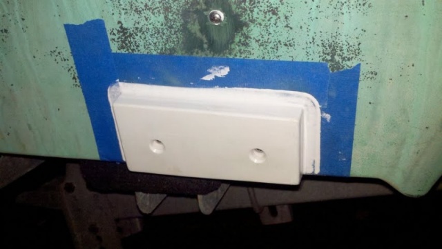

Would 4200 be up to the task as well, or is there a risk that it would allow water behind, or fall off after some amount of time? I was thinking with the undercut and epoxied holes, and screws reinforcing the adhesive, could be enough, you know in case I make some sort of 'unforeseen' mistake. Smile
If 5200 is used, even though it says it is "permanent" and has no removal instructions, can anyone confirm that it's stubborn but removable with a cutting wire to separate glued faces (i.e. swim step or StarBoard)?
PS - if anyone wants more crude sketches for a thread like this, I may be able to help!
Posts: 21505
PostPosted: Thu Dec 08, 2011 9:08 pm    Post subject: Reply with quote
I have removed 5200 a number of times. You can cut it with a hot wire. You can use a hot putty knife/heat gun. You can use "Debond" or "Anti Bond" both are solvents for cured 5200 and will loosen it.
I stick with the 5200....Starboard is difficult to get adhesives or sealants to stick to. That is why I like to have undercut/not just notch, in the back of the 5200 block.
Could you use 4200--sure. Might not adhere quite as well or be as strong. But the screws alone are plenty to keep the block in place.

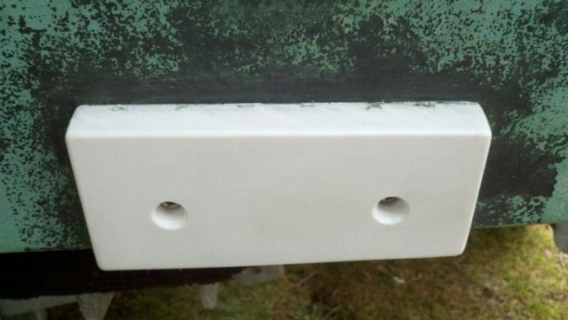

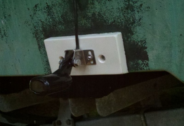

I finally took some pictures of recent projects and uploaded them. I took a few during the installation of my transducer block.
I used 3/4" Starboard (you can buy as small as 12"x12" pieces on eBay) and cut it to 3"x6". I used one hole that was already there from the old transducer and drilled another hole for the other side. All 3 holes were undercut and filled with thickened epoxy.
I positioned the block and traced its shape on the transom, then measured to the holes and marked the holes on the block. I drilled the block and then used the block as a template to drill pilot holes into the epoxy filled transom holes. The pilot holes (and screw penetration) are of course shallower than the plugs themselves! I traced the hull profile onto the back of the block, and used a straight edge to transfer the hull contour onto the sides of the block. I used a jigsaw with the foot tilted to match the angle drawn on the sides of the block and cut the block. It seems to extend the shape of the hull smoothly!
I used a drill bit larger than the screw head of the screw I used to countersink the screw holes. I also used a countersink to bevel the hole edges. The block holes were drilled larger than the screw thread size so that the block could be tightened against the transom. I used a dremel router bit and cutting wheel to 'score' the back of the block.
I masked around the block's footprint on the transom using painters tape. White 5200 was squeezed into the cuts on the back of the block first, then liberally applied to the whole block area on the transom. The block was attached to the transom with screws that would penetrate shallower than the epoxy plug depth. 5200 oozed out continously as I tightened down the block.
After full cure (7 days), I came back and used razor blades to cut the 5200 ooze flush with the block edges and peeled away the tape. It seems pretty solid, and with this much care I hopefully won't get any moisture in the transom!
