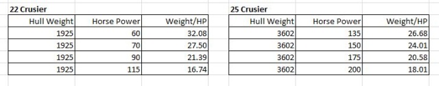

If you look at just the hull weight to horse power and then compare it to what people are putting on the CD22s some thing is out of wack. It looks like the 135 would be about the same as a 70 on the CD22. If there is no plan to run the boat at altitude looks like they perform ok. At Yellowstone I still want some more power. Of course it would help if I would leave 500lbs of gear at home. Just something to think about.

Jody, it's worse than what you think. My estimate is that when we cruise with Journey On, we weigh about 7400 lbs, with 2 people on board. And yet we're happy and the boat does well. And good. At 7400/150 = 50 lbs/hp. I don't know is you can double the C-22 weight.
The advertised boat weight for a C-25 is awfully low, and must be for just a bare hull with no interior, etc. Remember, there's no batteries, hot water heater, and most important, no cruising gear. And no engine. Or people.
And as for reaching 30 knts, that water must be as smooth as glass. I've had it up to 25 knts in San Diego Bay, with some small ripples, and I thought the darn thing was going to fall apart. We'll cruise at 14-18 knts and be happy.

I think the reason the loaded up CD-25's tend to run so much heavier proportionately than a loaded up CD-22 is the internal volume relationship.
There's simply a lot more room in a 25 than a 22 in which to cram extra stuff! (Some of which you may not really need!) Add in the head/shower and any other accommodations that allow the Admiral to bring on her accompanying baggage/equipment/wardrobe/necessities, and the weight can go through the roof!
I want you to consider the following little understood math concept:
The 25 is not simply 3 feet longer than the 22:
1. The outer skin (hull) weight goes up with the square of the linear dimensions, while
2. The volume contained inside the hull (and thus the capacity to add weight inside the hull), goes up with the cube of the dimensions.
dimension = 25
dimension squared = 625
dimension cubed = 15,625
dimension = 22
dimension squared = 484
dimension cubed = 10,648
ratio of linear dimensions = 25/22 = 1.136 times as long, wide, etc.
ratio of surface areas = 625/484 = 1.291 times as much hull area (AND hull weight!)
ratio of internal volumes = 15,625/10,648 = 1.457 times as much internal volume and 1.467 times as much space to load up with STUFF!
It even gets worse when you figure that in either boat you can't load up the passageways with stuff, and that in a 22 those are a proportionately larger part of the interior than they are in a 25, and thus the 25 again has more space or volume for CRAP ABOARD!
It's a good thing this hull length/ hull weight / load carrying capacity thing works, or Noah would have had to build the Ark super tanker sized out of 2x4's!
Luckily, volume = dimensions cubed!
