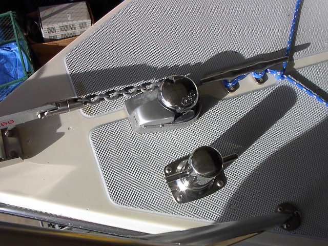

I've been perusing multiple galleries lately, looking for anchor roller pics. If you have the Lewmar pivoting roller, and a picture that shows it well in your gallery, could you let me know? I'll keep wading through the photos in the mean time.
Thanks!
PostPosted: Fri Oct 21, 2011 2:42 pm    Post subject: Reply with quote
Thanks!
Here's some:
Joe Teeth Thumbs Up

PostPosted: Fri Oct 21, 2011 6:20 pm    Post subject: Reply with quote
I'll try to take a few shots of the install on THATAWAY and CAPTAIN'S CAT shortly. One is with the vertical 700 and one with the horizontal.

PostPosted: Fri Oct 21, 2011 7:23 pm    Post subject: Reply with quote
Thanks for the pics! I think I have enough info to start the project when I get a dry weekend. This will be my first dremel/epoxy project. I have the materials and tools -- I just haven't been ready since I didn't know which roller to install and where. I think I can return the rigid roller to Defender (purchased less than 30 days ago).
