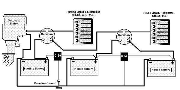

I am trying to get some feedback before I blow up my batteries.
The only sketch I found that looks like what I am trying to do I found in the first picture under electrical pictures. I have two four position battery switches but in all the reading I have done I do not read anywhere where anyone is using this setup. I do not have the buss panel shown on the right but everything else looks like what I have. What do you think the little black boxes with the 50 in them is? Is this a charger?
I have just installed a xantrex 2 three bank charger an I am a little afraid to turn on the switch.

Let's make that diagram a little larger:
And a LINK to the diagram itself with some discussion.
Looks like it would work to isolate the starting battery from the house bank, but also allow one to use the house bank for starting.
The two C50 (s) is probably a two bank 5.0 amp charger.

Thanks for making it larger. I tried without success to paste this in the post. I guess I am wondering why people use so many electronic components when this is so simple and appears to work as long as you don't mind switching manually.

The problem I see here is that teh engine is not charging the house batteries unless both switches are on both.
If the point is isolation of the house batteries, one must throw the first switch to 1 or "off" after running the engine. Then if one forgets to throw the switch you could run all day, and not charge the house bank.
Now, if switch one were replaced with this:
http://bluesea.com/products/7650
the batteries would be isolated, but would be charged anytime the engine is running, as well as have the ability to bridge the house batteries with the starting battery should an accidental discharge require it.
Without this system, you might also run into issues when charging because of the disimilar battery bank sizes.
I guess it's all in how you look at it, bit I find the two switch set-up more complex and prone to incorrect setting. But that's just me.

That's what I use. However, I think you could use an ACR in the first setup to do the same thing.

Thanks Matt, That is sort of my problem. I do not fully understand the operation of the switch that you recommended. I will gladly take your advice. I would like to know how you would normally run with the switch you recommend and when I install it which switch should I replace. The one in the diagram nearest the motor?

My thought would be the switch nearest the motor should have the Blue Seas unit. It has an Off/On/Emergency switch.
Basically, when on, the engine can charge both battery banks, but they remain isolated from each other. The black box determines where the engine's charging voltage goes- first to the starting battery to top it off, and then to the house battery bank.
When the key is turned off, and no charge voltage is present, the battery banks are isolated.
Should the starting battery becoem discharged, moving the switch to Emergency Start brings the house bank online so you can start the engine.
I like this unit because it's one less switch to worry about. Turn it on when you get aboard the boat, and leave it alone until you're done with your journey.

I may confuse the issue, and don't know where that diagram came from, but it is not the way I set up a boat. You do NOT want the electronics and running lights running off the engine start battery, which is basically "hard wired" (by being on the output or common of switch #1) to the engine start and charging system. There are two reasons: 1. is that you do not want to have the electronics on the battery when you start the engine--the voltage will drop, and as the alternator kicks in, there may be voltage spikes--so both of these are bad. Also leaving these, and any running lights on, may drain the starting battery.
Why not combine the two identical house batteries, in one bank--the single start battery in an other bank? The house then are connoted to the alternator output by a combiner (or what Matt describes--which I believe is just another form of combiner). The Voltage sensitive relay or combiner leaves the battery banks isolated when the voltage is less than 12. 7 volts. When the engine starts, and voltage is up to 13.4 volts, as the starting battery has started to charge, all three batteries are combined, and charged. As you stop the engine, and the battery voltage drops to less than 12.7 volts, then the batteries are isolated. This has nothing to do with the "key" --as Matt eludes to--and that may be a function of the product he depicted. (There are ways that combiners can be controlled with various switches). You can still use the two battery switches which you have, and just add a combiner or VSR. This ends up with a "fool proof" system, and no switches to throw under normal circumstances. (The "both" of the current switch will combine the two house batteries, and you can keep that if you wish).

To clarify, I mentioned the "key off" as shutting the engine off. The ACR sense voltage as Bob mentions. Turning the key off, shuts off the engine, and it's charging system, which drops the voltage to trigger the isolation of the batteries. The key really has nothing to do with the operation.
And I agree, I would probably eleiminate the second switch, as it creates the issue where if set to 1 or 2 would allow only one house battery to be charged. Best to use both batteries as a bank.

Generally the best practice is a bus bar near the batteries. All of the house items (includes all electronics, lights, refer etc) run off the bus. I like to have a "on/off" switch between the battery and the bus--to eliminate any potential drain on the battery when I leave the boat. (such as memory of a stereo or chart plotter etc). The bilge pump is often directly wired to the house battery as a safety issue.
The 1/2/both/off switch will allow you to change an engine start to the engine battery or the "house" bank of two batteries. The combiner will charge both the start battery and the two batteries which are the house bank.
