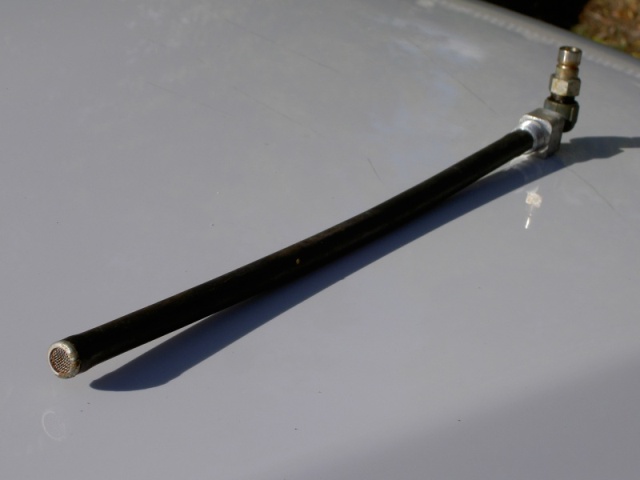

Marc, do you sell or know where I can purchase two aluminum pick up assembly's that would fit the CD 22, year 2000, twin 20 gal tanks.

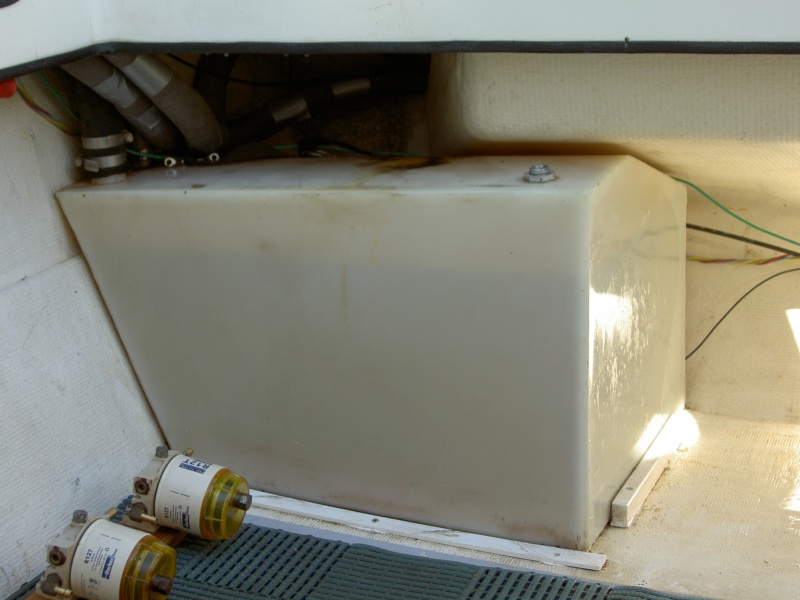

My fuel tanks leave an inch or two of fuel when I run out. Near as I can tell a couple gallons. So 25 gallon tank can only use 23 gallons. I would like to redo the pickups in my tanks as well. I think mine comes from the level floor and the pickup being forward in the tanks and straight up and down. I read some where about somebody changing theirs to like what's in a snowmobile the pickup is horizontal with flexible hose and a weight to keep it on the bottom. Aluminum tube available at auto parts store could be bent to pickup at the rear of the tank. Could use stainless as well available at tube supply like Marmon Keystone in Salt Lake. Submersible hose made by Gates Rubber could be used too. Can you take some pictures of the pickup? Do your tanks sit level or do they slope because of the bottom? Are there screens on the bottom of the pickup?

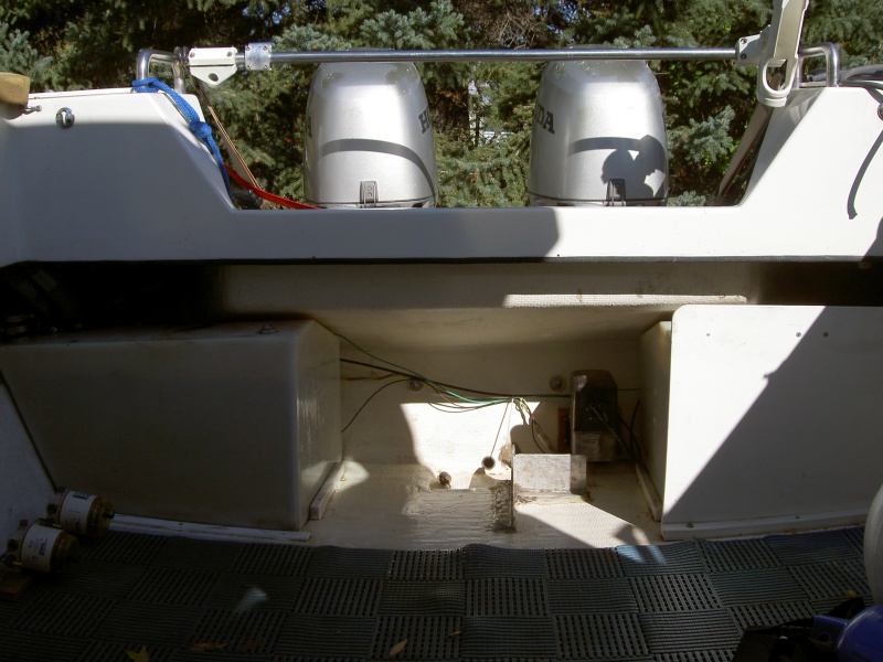

Tanks slope & pick up location is in a good spot. I believe that's the reason they drain all visible fuel before running empty. With the 20 gal tanks can add a gal or two extra & get just over 20 gal usable fuel out of each tank. Its working so well hate to mess with this at all & wouldn't even be thinking about it except for the ethanol issue. As you can see there are screens on the bottom of the hard plastic pick up tubes. What I was hoping to do was find a set up already made like the one shown that I can cut to exact length made of aluminum or stainless. As someone else mentioned the tanks do flex & noticed the stiff plastic is slightly bent to the side. This occurred with both pick ups & didn't stop fuel flow when they made contact with the tank bottom. Think the hard plastic is just flexible enough to allow some bending which keeps the bottom screen at a angle when it contacts the bottom of the tank. Do to this working out so well for the last 11 years am now reluctant to change to other material. Was hoping to find others thoughts on it holding up to ethanol & for how long. Wouldn't be adverse at all to keeping it the same set up with a change out every so many years if that would work. The flexible hose with a weight like you suggest may work well to with ethanol proof flexible rubber.

It looks like the bottom of your tank follows the slope of the floor. That would seem to help run the tank all the way to empty. If my pickup looks like yours I would guess mine is to short. I guess I will have to take mine apart and have a look. Thanks for the pictures.
