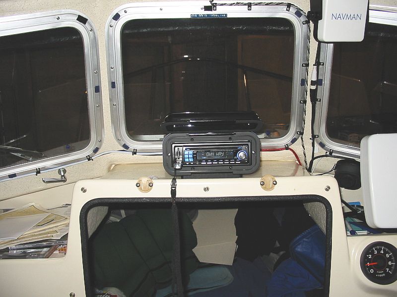

PostPosted: Mon Jun 27, 2011 8:27 pm    Post subject: Reply with quote
Simple "SeaWorthy Sea-Ant" antenna shown strung to left @ bottom of window where it terminates after 24".
Under $6.00 shipped.
Click on the pic...
Pete
