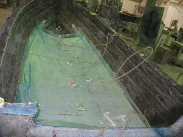

Here's the only photo I've seen of vacuum pressure being used at Triton:

Looking at the C Dory Factory posts they refer to vacuum bagging the bottom core--either balsa (C Dory) or foam (Venture). The photos show vacuum bagging. No reference to resin infusion.
I think that the weight savings would be minimal--but that the resin penetration and distribution will be excellent. Vacuum bagging is used often in exotics and with epoxy to get a very light hull. However in the C Dory it appears as if the rest of the hull/deck etc is conventional layup. There would be no reason to decrease the lamination schedule with vacuum bagging, although there will be slightly better resin penetration and slightly less resin, but the same amount of glass.

Good responses from all of you. To answer your question there will be minimal weight savings with the vacuum bagging process as it is only used during the bedding of the core and transom.
The molds at this current time are not setup for infusion which by the way we pioneered in our style and size of boat. We started utilizing resin infusion back in 2000-2001, and by 2005 had all of our Sea Sports and Osprey set up for infusion. When I make the shift over to infusion for Cdory, which we will, you will see an even stronger hull being built. It is not necessarily more expensive to produce, actually we noticed a slight cost saving to traditional methods, it is the initial setup of pumps and lines that is more expensive.

I have done a fair bit of vacuum bagging, which is what is shown in that photo. The wieght is reduced because the the process pulls all extra resin out of the part (it ends up in the the breather and peel ply, which is that white cotton looking stuff under the plastic bag.) The wieght savings can be quite a bit too, depending on what other method of constuction you are comparing it too. The strenght is greatly improved do to the removal of any air in the glass/resin. In my opinion a vacuum bagged part is far superior to a non vacuum bagged part.
