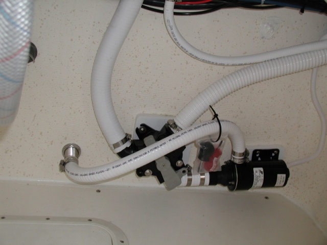

PostPosted: Sat Feb 19, 2011 10:31 pm    Post subject: Reply with quote
Thanks Roger, I knew it was one of you guys! How high above the waterline is the overboard?
And, where did you put the switch and how is it fused?
Dreamer
Joined: 01 Jan 2006
Posts: 1766
Photos: Dreamer

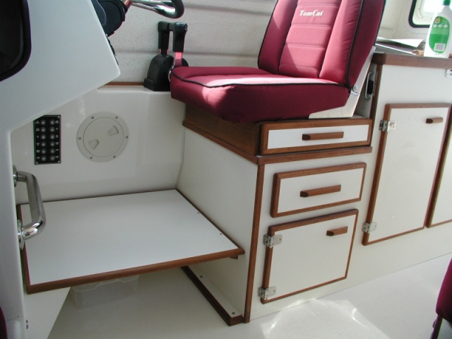

PostPosted: Sun Feb 20, 2011 1:19 am    Post subject: Reply with quote
Charlie,
The dark half circle in the previous photo in the upper L. is the sink drain. So the pump out is about 12" below that. It's about 6" above the waterline. Switch is behind the helm seat with a drawer handle surrounding it to prevent accidental actuation, 20 amp inline fuse. It can be seen here behind seat back hinge.
We keep a zip tie in the lock hole to keep the coast guard happy. It's open all the time in Canada. Wink
