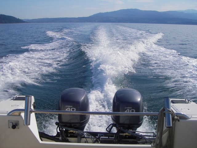

PostPosted: Fri Apr 29, 2011 3:29 am    Post subject: Reply with quote
I have owned several of the Yamaha 115 4 strokes--one of the best engines made. The reason to choose Yamaha is two fold--one he has the boat already rigged for Yamaha. Second is that in salt water the Yamaha has less corrosion problems than the Honda's.
And the service-ability for Yamaha is much better. Better access, more places, and easier parts availability.
AND, I'm not saying anything about the Twins idea but......
There are reasons........ Thumbs Up Thumbs Up
