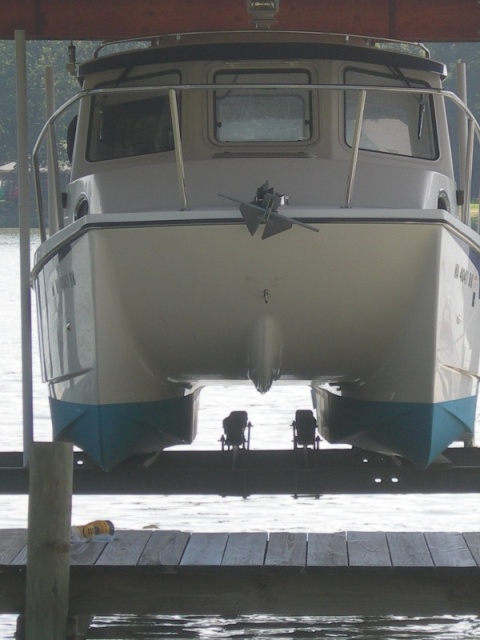

Paul, I don't think it's a critical measurement. Take a look at the picture here
A 22 has a pretty flat bottom. The two things in the middle of the supports are my twin Honda 45's. I'd say as wide as possible without getting near the chines and then place your positioning poles (or whatever they're called to ensure you get it as close to centered as possible. May take a few adjustments but that's not too hard if you have a lift like this one. For the TC255 that came after this one, I just moved these to the center to fit in the tunnel and put flat planks down on the lift bars to support the twin hulls.
