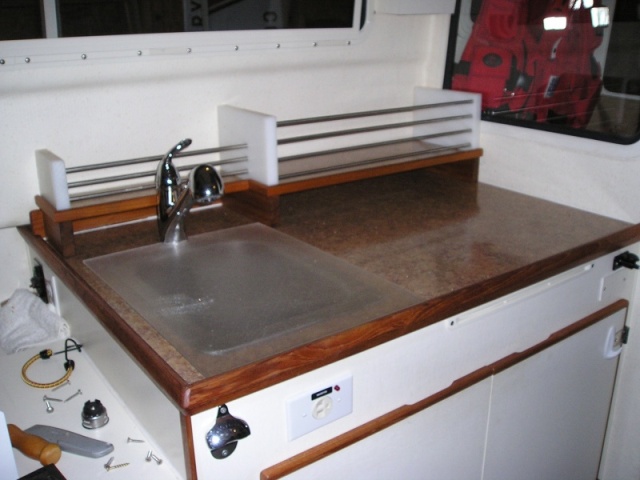

Yes, I do, unfortunately I am on Maui right now and don't have the name and model number. HOWEVER, Pat on Daydream put the same one on his boat and I am sure he will provide the info.
Here is a picture of it.
The faucet also comes out and can be hand held.

We have the same type as David - it's a Moen; bought it a Lowes or Home Depot. You can replace it with pretty much any type. The pull out sprayer works good for washing hair, rinsing dishes, etc, etc.
The hardest part of replacing it is getting at it. It was easier for me to remove the sink to get at the plumbing.
Definitely a very worthwhile mod. No idea why the mfg would put that two handle faucet in other than price. You waste less water with the single handle.

It's a Moen 87315C if you prefer the chrome finish. You'll need a couple of nylon adapters from pipe thread to 1/2" hose. And yes, taking the sink out makes it pretty easy. I remember Jim B calling me in the middle of his install Wink
