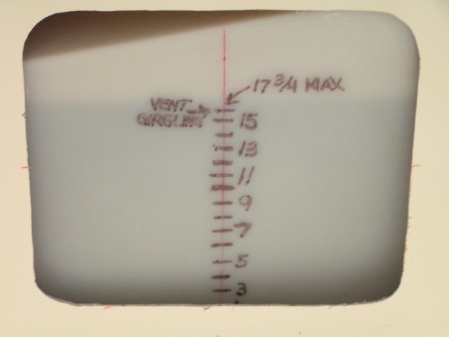

I put a hatch in front of my tank (max corrected to 16 3/4 gals -- tank installed on a bias), or you could use a 1/2" or so slot. Not sure where your tank is though, might not be suitable.

Colobear, I would be interested in the photo of the tube. My 22 didn't have such a tube. The vent is usually at the top of the tank. A vent under the water, would cause a partial vacuum when water was withdrawn. Maybe this was put in as a "guage"?
Steve, interesting that the "20 gallon" water tank will only take about 16 3/4 gallons. I wounder if you relocted the vent, if you could at least get 20 gallons in it? I picked up a 35 gallon bladder tank for the CD 25, looks like a good "investment" if the boats only carry 16 gallons!
