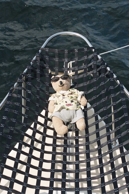

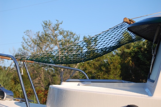

marvin4239
Joined: 06 Feb 2007
Posts: 1165
Vessel Name: C-FLE II
Photos: C-FLE II
PostPosted: Wed Jan 12, 2011 2:44 pm    Post subject: Reply with quote
In my photo album in the modifications folder is a picture of a hammock I made that attaches to the roof rails and bow rail. It's really handy, comfortable and stows easily
marvin
PostPosted: Wed Jan 12, 2011 4:20 pm    Post subject: Reply with quote
Marvin, here is the photo of your hammock. Nice ideal
Great minds think alike, Marvin. We've had one for years and there's nothing like it.
Al

marvin4239
Joined: 06 Feb 2007
Posts: 1165
Photos: C-FLE II
PostPosted: Thu Jan 13, 2011 11:46 am    Post subject: Reply with quote
Hey Moose I agree although I think I got the idea from you!
