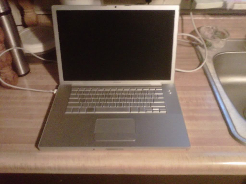

I bought this today used 07 macbook pro for $600 bucks. I took it up to Best Buy and had it checked out, resident mac expert felt I got a steal on it. Titanium shell and updated software. New Battery too. Smile
I have a history of killing laptop (PC's up to now) quick. I'm yet to have one last a year. People keep telling me, pay up front, buy a mac, so here it is.
I use computers for the following: email/internet and storing pics/word docs. I have a desk top for much of that. I want to use the macbook as a GPS unit in the 22-cruiser only. I suppose the next step is buy a GPS "puck" with software? I'm so confused as to the difference between what is often referred to as real GPS and then simulated GPS using WiFi (like my blackberry?)

I think you'll like the MacBook Pro - ours have been real troopers. Looking at the photo, it appears you have one similar to our 15", circa 2006. If so, it has a 2.2 duo core processor and probably 100 gig hard drive. The typical install had 1 gig of RAM; I think it was expandable to 2 (not certain on that). Ours has been with us on Wild Blue and in the RVs since we bought it. That model has a battery that will last 1.5 to 2 hours when new, so if you intend to use it on the boat, you will want a 12v power cord for it. Even though it is a durable machine, we have always carried ours in a padded case.
