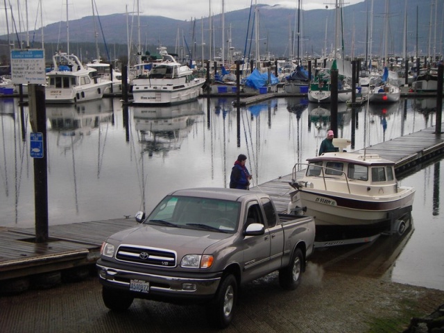

I have a bunk trailer, and generally with it backed into the water until the tops of the fenders are submerged about an inch, I can pull the boat up onto the bunks close enough I can reach the bow eye from standing on the trailer tongue. I don't have, but have seen, trailers with a bit of a catwalk built onto the tongue to eliminate the highwire balancing act there.
This was an early launching. I later learned to back down to where the rear pickup wheels are just at the waters edge,and that puts the trailer where the wheel fenders are just covered, and the boat goes both on and off much easier.
