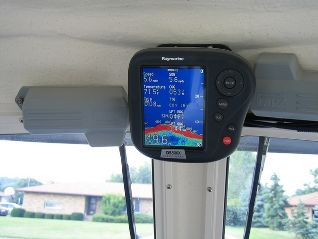

Since I never intend to fit radar to our 16 Cruiser I'm looking at the Raymarine 435i GPS/chart plotter. These run ~$800 street price ready to place on the dashboard and run. Plus chart chips, of course!
The 435i has a 6" diagonal screens (portrait oriented) (vs 6.5 landscape for the C70) and is totally self contained.
The 16 Cruiser is dash challenged, even in comparison to the 16 Angler! I may end up fitting an overhead pod, or a pod on top of the dash itself for the plotter, fishfinder, and radio. I currently have the fishfinder mounted top center of the ceiling between the wiper motors. This unit will repeat GPS data, but won't serve as a chart plotter.

Chuck:
The fishfinder looks great up in that location. That is one of the Raymarine units I'm looking at. Trying to decide between that particular model and the DS400x.
As for the C70, if you havent purchased your 435i yet, I would go take another look at the C70 model. The graphics are considerably better and the ability for the unit to redraw a navigational chart is light night and day. Consider it a faster computer if you will. Perhaps the antenna will go in front of the steering wheel, on that flat area, all the way forward by the window.
I've also considered a shelf.. but as you know we're so limited on space in the 16' Cruiser. As of know, my intent is to place the fish finder where yours is, have the chartplotter centered in front of the steering wheel and the VHF on the interior hardtop above the chartplotter, perhaps set a bit forward.

The DS550 is mounted where it is so more than just the wheelsman can see the display. My driveway doesn't have 50 feed of water in it but these are the normal displays I use with the unit. It's picking up GPS information from my old Garmin 75. This mounting isn't optimal due to the display being in shadow and the glare thru the windshild, but on a 16 Cruiser the dash has very little room as the only place I can figure out for the VHF-FM is on top of it.
