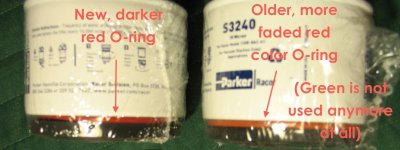

Posts: 1176
PostPosted: Sat Jan 26, 2013 7:46 pm    Post subject: Reply with quote
I received a package from Racor today, so I thought I would update this thread. The tech person kindly sent me a new filter unit with a new O-ring (year of manufacture, 2012), plus two new O-rings, and two of the older red O-rings for comparison. He noted that the green ones are no longer current. He also said that the "diameters are different" between the older and newer red ones, but I'm not sure if that means overall circle size or cross section of O size (not certain I can ascertain by measuring either).
That said, the color is definitely different, although I'm not sure a person could tell them apart without seeing both. Maybe. I'd describe the new red as a deeper, truer red; and the older one as more of a faded or Nantucket red.
Interestingly, both the new complete unit (120R-RAC-01) with filter that I bought last summer from Fisheries Supply, and the replacement filter (S3240) that I bought recently from Jamestown Distributors had the old, lighter red O-rings. They were also both showing a 2007 date code.
Here are some photos that show them both (not taken in sunlight - maybe that would have been better but it's too late for that today):
These newer O-rings are supposed to help prevent the bowl from sticking to the filter (which ethanol exacerbates).
