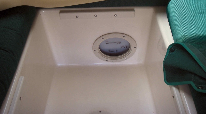

Here's the best way to show the water level on a 2005 CD-25:
Cut a rectangular hole, since it makes more sense. The round hole offers a smaller view of the tank, but then I was going to install an access port, a wast of time. Finally removed the trim ring. Be careful, since the tank sits only ~1/2 in behind the bulkhead.
Cheap, kinda accurate and easy to read. Level depends on the boat's attitude, so have the boat trim where it sits in the water. The tank holds 23 gal.

Posts: 3599
PostPosted: Wed Apr 28, 2010 11:06 am    Post subject: Reply with quote
toyman;
Well, the water hose comes from the front and the boat doesn't list when I add 23 gal of water so I figured it was in the center. I drilled a small hole so I could see up there, being careful not to go past the bulkhead. There it was!!!!!!!!!!!!
Yes, there was some foam between the tank and bulkhead. How much is in the rest of the bow is not of my knowledge. I thought that maybe it was used to give the tank some stability, cause there's a lot of volume up there.
