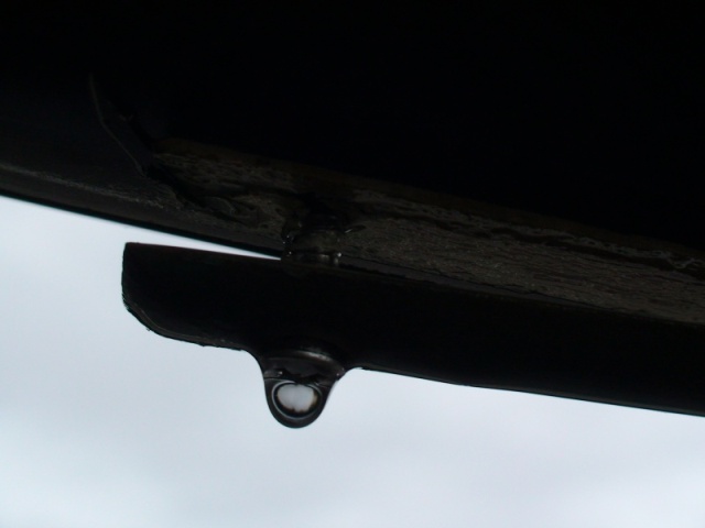

The screws that hold the brass stem guard in place are subject to pulling out of their holes. We found this out yesterday at Roche Harbor.
We had spent a night at Patos island and then two nights at Stuart island before going to Roche Harbor Friday morning. (By the way Prevost Harbor on Stuart is a great place to wait out S.E. - S.W. winds.) With no signs for concern to this point, we walked the girls up to the sculpture garden and then to the Mausoleum. Upon returning our runner on the cabin floor was soaked and Amy found water bubbling up through a stress crack near the porta potti. I immediately started opening the hatches we installed in the berth. We found alot of water under the berth. We were able to bail the water, maybe 15 gallons, with a Gatorade bottle. We assessed the situation and realized water was not gushing in. So we checked the weather one more time and made a b-line for Bellingham and got the boat on the trailer. Where we found the source of the water.

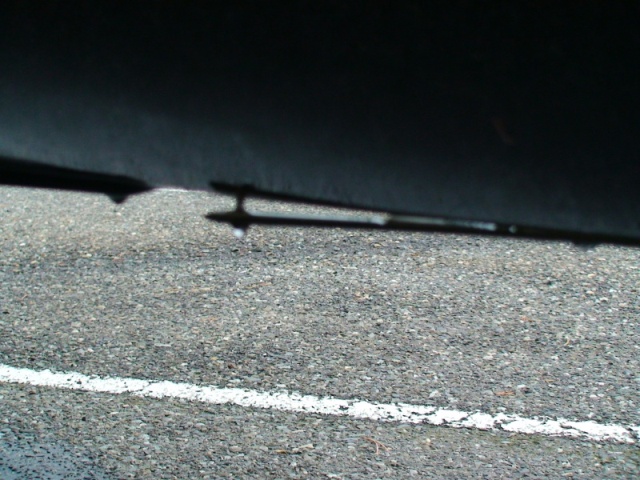

The lowest screw on the brass stem guard had pulled out completely. The screw hole is totally stripped. Here are a couple pictures.
We feel lucky that this happened when it did. We were relatively close to the trailer and we had not been away from the boat for very long. And this is an easy fix in my mind.
My question to those who know is what is the best way to fix this problem? I intend on correcting this problem on all the screwholes for the stem guard.

I would pull the entire stem guard, dry out the area; including washing well with fresh water. A shop vac hooked up to this area, can help get more water out. Heat will also help. After it is dry, drill out the holes, and counter sink the outer skin, then put in epoxy, with mill fibers, or short pieces of cloth into the old holes. Work the epoxy and fibers/Cabosil into the old holes with toothpicks. Then refair the seat for the brass strip, redrill pilot holes, and re-install the brass strip with 5200.
