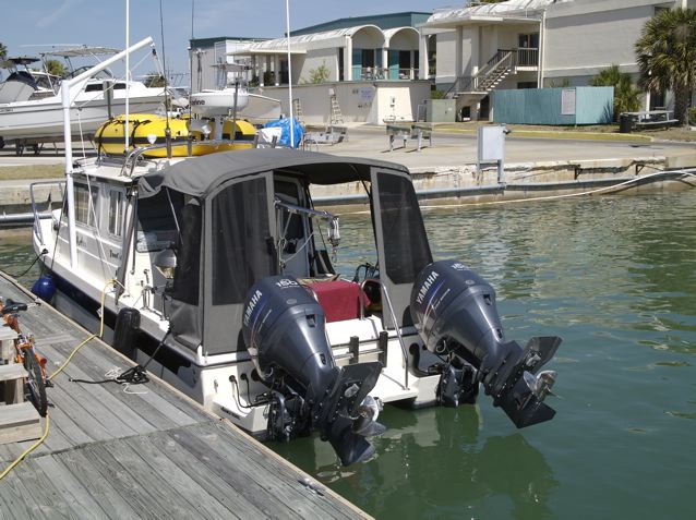

On my Tom Cat, with Yamaha 150s a hose-like material, that looks much like a shop vac hose, covers some of the electrical and fuel connections from the hull to the motor. This has broken on one of my motors. I would like to replace it and need to know: (a) what is it called, (b) where can I buy it, and (c) how do I disconnect what is inside the hose?
You can see a bit of what I am talking about in this photo.
Thanks!

Warren-Fisheries Supply sells
"Slit Wire Harness Conduit - Split Loom" made for that purpose. No need to disconnect anything

And the ends are secured with nylon cable ties (heavy duty ones). Mine have slipped off of the rubber inserts on the engines Warren and I need to resecure them.

Actually, the product used is not a split loom material. It is much heavier, and is solid. It is called outboard rigging tube, or rigging hoes.
Here's one brand:
http://www.jamestowndistributors.com/userportal/show_product.do?pid=9130
Your local dealer should be able to get it, if they don't stock it.

I assume you are sure it's broken (cracked, etc.) and did not just come apart. Mine has a solid segment in the middle holding the shop vac looking hose on both ends. I had to resecure mine once as well (I initially thought it was broken until I looked closely).
Good luck - looks like Matt identified the proper material.

Thanks, Matt! And what is involved in replacing it?
Yes, it is broken about 6" away from the motor. I have had ongoing problems with it and am wondering if it ages and gets brittle.

The bad news? Everything must be disconected at the engine, old tube slid off, new tube slid and and reattached, the reconnect everything. Not difficult, but time consuming. A split loom type would be easier, but would allow water in.
