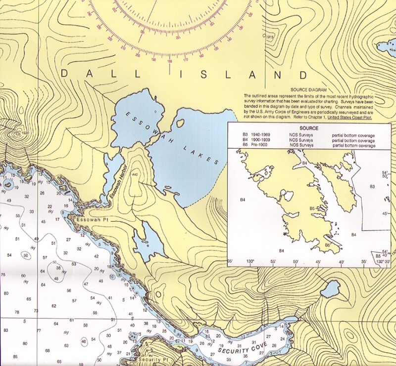

Boris,
If I understand vector charts, they use the same information as the raster charts. The data is taken from the original surveys and can only be as accurate as the surveys were. If the surveys are recent, then the data may be accurate, but just showing inaccurately located data in a cleaner format doesn't help.
When raster charts are drawn, the finest line used is 1/2 milimeter wide. On an 80,000 to 1 scale chart that 1/2 mm line represents 120ft on the water. See Nigel Calders 'How to Read a Nautical Chart' book for a thorough discussion of charting and chart accuracy.
Basicaly, any chart, of any format, can only be as accurate as the source data. Paper charts have a legend showing when the surveys were made.
Here is a scan of a remote area in SE Alaska, and you can see how old the surveys are. The edition date of that chart is '02 with corrections applied thru '07.
Security Cove was charted from surveys done from 1900 to 1939, with only partial bottom coverage. No matter how good this chart looks in any format, its still just approximate.
While the rocks don't move, not all of them have been found yet!
