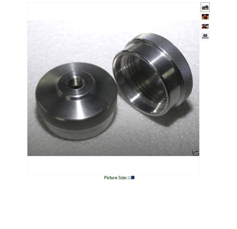

I'd just left my reply (above) and started my search for a yamaha generator fuel cap when I immediately found this HONDA Eu2000i GENERATOR EXTENDED RUN FUEL GAS CAP for just $35.00. It doesn't work for me but it looks like a good option for the Honda guys.
