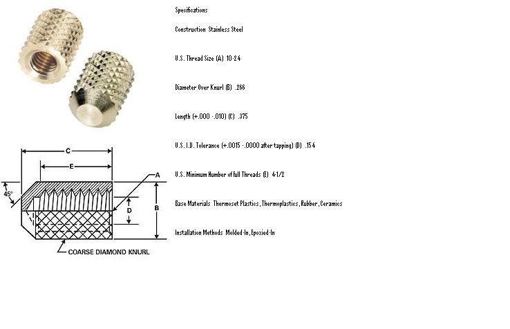

I went back later and drilled out the new mounting holes and epoxied in some stainless inserts for greater strength and water-proof integrity. It may be overkill but I rest easier. Wink
Yardley Inserts

The SS inserts will work well, as long as the holes match up. But the King Starboard will allow many different positions of the screws for transducers in the future. Unfortunately there is no "standard" for transducer mounting brackets.
