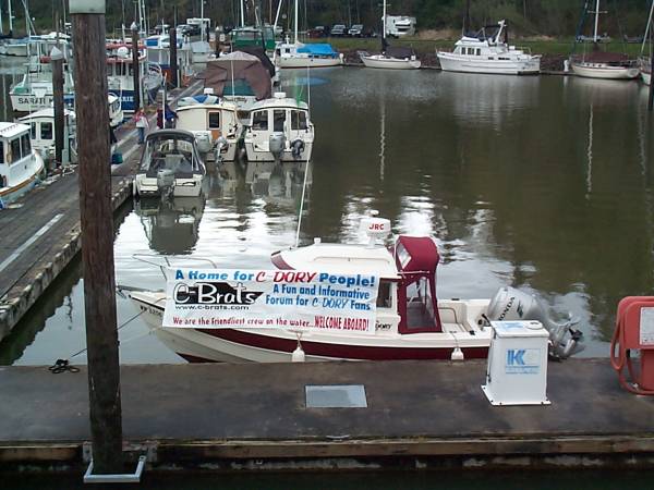

I finally found a picture of Mar-T. Not a good close up of the top, but enough to get the basic idea.
I think that I would like something a bit more simple than a dodger, preferably using one short removable bow.
Still looking for ideas.
