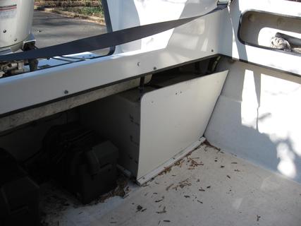

Here's the photo of Rod's gas tanks in his boat.
I told him in a PM that I thought these looked like the standard later model Mollner polyethylene tanks, but couldn't be sure, as mine are different on my older '87 model Cd-22.
What do you all think?

That looks like one of the standard tanks, but it is hard to tell from the pic. If the boat does have fiberglass tanks they were likely installed after the fact. I do not believe C-Dory ever used fiberglass for tanks. When I replaced the tanks in my CD22 with the latest style of molded plastic tanks it cost about $500 for the kit, so if the surveyor is sure they are glass and should be replaced, that will work for a negotiating price.

Ours is a 2000 CD Cruiser has polyethylene tanks and looks very similar if not identical to this photo. With the tanks being in the shade in this photo its hard to tell for positive.

I doubt they are fiberglass but if they are things could be worst. With c-dory you could just pull them out and order new ones. Little bit of money but not much work. On a lot of older boats, big and small, glass tanks are built in and you are not able to pull them out, you have to cut them out or line them with something.
