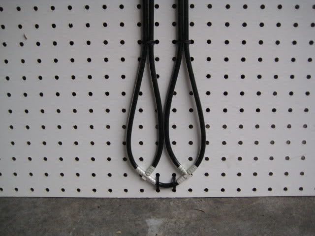

Lastly, I built the manometer referenced in Richard's article above. That was a real life-saver. The only thing I had missed (but that was stated in Richard's article) was that the four tubes need to be open to each other, i.e. linked with T's, or submerged in a common reservoir of oil. At first, I had all four capped with equal amounts of oil in them, and thought I must have the best balanced carbs in the world!!! Here's a picture of what I eventually did to hook them up:
As to part numbers, I used the following parts from Dorman/Vacu-Tite! :
47406 (soft vacuum connector--had to shave these down to fit them into the intake holes, which I did by chucking them up in a drill press and taking a sanding block to them--if you can get "real" takeoff cones, I would highly recommend it--these were touchy at best)
47303 (3/16 x 3/16 straight barb, used to attach the above to the 3/16 tubing)
47311 (3/16 vacuum restrictor)
47334 (3/16 x 3/16 x 3/16 vacuum tee)
Also got 2 x 20' rolls of 5/16 OD x 3/16 ID x 20' vinyl tubing at Home Depot, and used 10' per carb on the pegboard.
As stated in Richard's article, I used 2-cycle oil for the fluid.

We went through the mixture screw adjustment again, and seemed to find the sweet spot at about 2-2 1/4 turns out for each carb. We had set the idle speed to 950-1000, and this brought the dashpot adjustment right into specs. We synced the carbs with the (then faulty) manometer, and hit the water again. The motor has never been so sweet and smooth. Acceleration was immediate and smooth, and the missing/rough running was totally gone. I can still kill the motor if I put the hammer down extremely fast from idle, but I'm not sure that's out of the ordinary. If I go at any human speed, it just pulls out and runs like a Swiss watch.
Today, I fixed the manometer, and hooked it up. Even as smooth as the motor already was, I found that the carbs were more than an inch of mercury apart, and so I set about syncing them properly. When I had them all within 1/16 of mercury to each other (one pegboard hole on Richard's manometer), I checked balance at higher rpms. I found that #3 was always higher than the other three, and so I ended up setting it about 1/8 lower than the others at idle, so it is more or less even at speed.

P.S. One last photo, in progress for the sync. #4 is still low, 3 is medium, 1&2 are high. Old batteries strategically placed because I get tired of wet feet...
