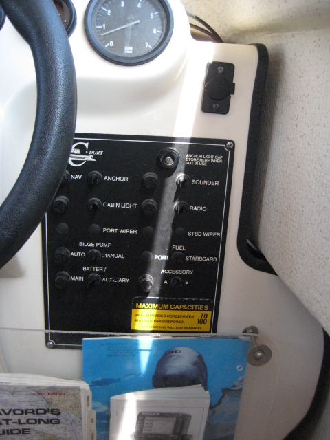

Hi All,
Hoping some one can point me in the right direction, need to find a replacement anchor light cap the one that mounts on the electronic control panel see below picture - (1995 22ft Cruiser Model):
upper right side of the panel has the words"Anchor Light Cap store here when not in use" - I need one of these caps?
Paul

The anchor lights are made by Perko. There is a link to the Perko catalog in the thread below. An easier fix may be to use one of the plastic caps that comes on a 1lb propane bottle. I haven't actually tried it, but somewhere I read that it fits perfectly.

I don't know if they sell JUST the cap, but it's a Perko unit so perhaps you could ask your local Perko dealer.

Maybe this will help.http://www.iboats.com/Perko_Replacement_Base_Cap/dm/view_id.134217

I'm still using the propane bottle cap. It has been up there for about the last six months and several thousand highway miles and just keeps holding on. Plus, if I need a replacement I just walk out in the garage and grab one.

the nice thing about the disposable propane bottle cap...there is no way you can crossthread it. Smile
