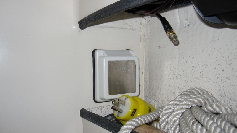

C-Cakes has the inlet in the starboard gunwale as SeaWolf Joe suggested.

My inlet was installed in the starboard gunwale. It worked out well for me. I wouldn't change a thing if I were to do it again.

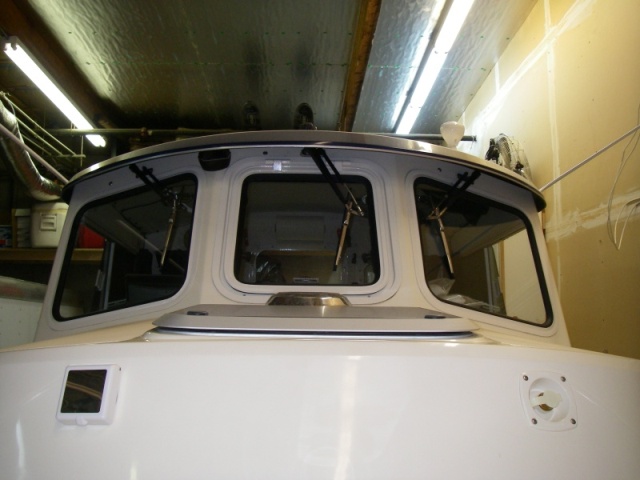

Here is an alternative location forward on the boat worthy of mention:
Shore power is the square on the left, and to the right is a water hookup. I have seen these features in action myself and they are very handy. The shore power up front can significantly reduce the power cord length needed and it tends to keep the cord out of harm's way nicely. When I went on a cruise with this Venture 23, there were two marinas where I could not reach the shore power with my gunnel mounted 25' cord whereas this boat could.

Oh, and I never had any problem needing more than 25 ft. but I'd be a little leery of the exposed inlet on that Venture. We occasionally get green water over the bow around here and in a saltwater vs electrical stuff contest the saltwater always wins.

Agree with the concerns about a bow mounted receptacle. Way too much salt water up there!!!
