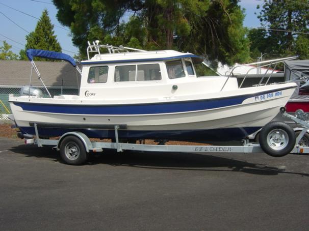

Hi, folks. I'm looking at setting up a carport/shelter for Honu and want to make sure it's tall and wide enough. The boat's not on the trailer now, so I can't measure it myself.
Does anyone have handy the height and width measurements of the 22 when it's on the trailer? I also have a short radar arch with rocket launchers, but I can always go and measure that separately. Here's a picture of the boat and trailer; it's a 2008 Cruiser. Thanks in advance for your information!

My 22 cruiser, C-Spirit on an EZ Loader trailer with rollers (not bunks) measured last summer was 8' 9" on the trailer. That was from ground to top of cabin.
Don't have a width for it.

"Sea Shift" rests her bottom on a tandem axle King Trailer (with rollers).
The height from the top of the cabin (not a tall cabin model) is 8' 2".
The width from the outside edges of the fenders is 8' 8".
The length from the tip of the hitch to the end of the engines in the down position is 30' 6".
When measuring the height, I noticed that the camperback frame work adds additional height.
I do have a radar arch with the radome on top, which gives the total height of 10' 2".
The shop that I had constructed has 12' high by 10' wide doors. If I were to build again, the doors would by no less than 12' wide as currently, there is only 8" on either side of the trailer when backing in the shop.

Ananda wrote:
Do you think I will be plenty safe making the opening 12' high, especially considering a future radome on top of the arch? Very Happy
In looking at the photo of your vessel on the trailer, the 12' high opening should accomodate your needs. You will be thrilled at having your vessel completely undercover and enclosed. When we return from a cruise, I wash the boat and trailer and it remains in pristine condition until I'm ready to take her out again.
