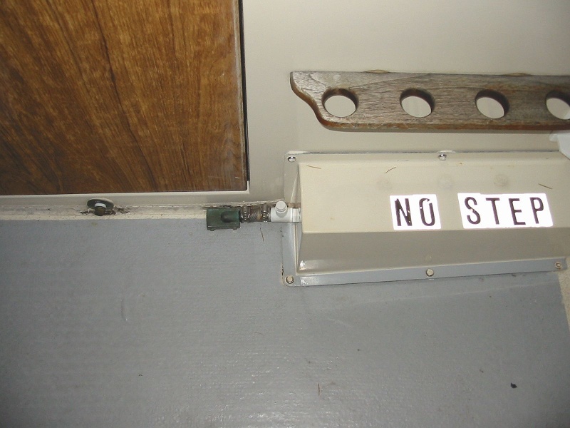

I had to access my deck-pump for another project and decided that I needed a better mounting setup for the cover than dabs of 4200.
My search led me to an interesting product that uses adhesive to surface-mount hardware fasteners instead of drilling holes. Possible uses could be my pump cover, fuel tank brackets, and transducer brackets. The bond is supposedly stronger than the underlying substrate.
