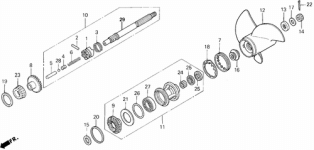

Saw a Honda lower unit on the block at a local mechanic's shop. The claw washer had all but disintegrated and froze up. Looked bad, and the mechanic told me that it was due to being left in the water, and that Hondas were bad for this.
So...while changing my props I checked mine...port engine looked fine...but the starboard engine's claw washer had swelled from corrosion, already split into pieces, and had swelled so bad that it warped the outer gear case end nut! Looks terrible, but evidently the seal is still holding. The end nut screws into the gearcase housing (this is the piece directly behind the thrust washer and prop) and there's obviously enough damage to have really messed up the threads in the housing. I removed 2 LOOSE pieces of the broken claw washer...one roughly an inch long...the other about a half inch...about 1/5th of the washer!

Claw washer??? Enlighten please, my 2006 Honda 40's (550 hours) are anxious and have no idea what you are referring to.
Thanks.
Thanks.
The claw washer is item #18 in the pic...end nut is #7. The claw washer has tabs that bend outward to "lock" the end nut in place. Both of these mount in the gearcase...not ON the prop shaft.
